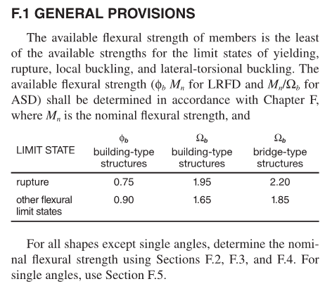

You'll need to reference each section of the ADM specification to see what the Omega factor is. Below is a snapshot from Chapter F which governs the design of members for flexure. As you can see below you'll have a couple different omega values depending on your governing failure mode and what type of structure you're designing.
