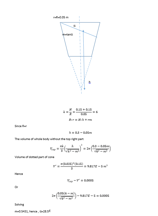

goutam_freelance, I am still having a hard time to understand how that equation gives you volume. How is water density not part of that calculation? I am very confused. Could you please elaborate that equation?
Yet again my not asking for a photograph leads to misunderstanding.
Water density doesn't matter if all you are concerned about is where the liquid reaches the lip of the cup. All liquids will have a surface normal to the local acceleration.
So, since those dimensions must be the inside of the cup you should be able tip the cup so the water just reaches the lip and the tangent of that angle is the ratio of horizontal acceleration to vertical acceleration that will reach that point.
Yeah, I realized that after engaging with you guys and reading up some more on that. But I am still curious how to calculate it from theoretical point of view. Goutam_freelance seems like is onto something, but I am not really sure how he came up with that equation where he finds tan(alpa). Years of not doing much hand calculations and relying on softwares must have dumbed me down. Are you able to see what he has done there?

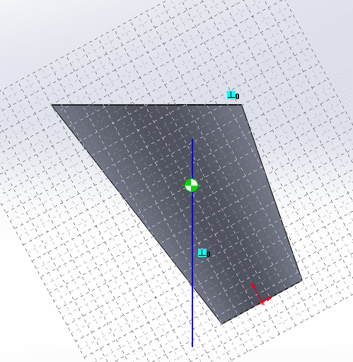

rather than looking at the ideal case of a steady acceleration and setting the water surface to the lip of the cup (and yes we haven't solved the volume of a cone cut by an inclined plane ... maybe do it in CAD ?) ...
I think the critical case was identified by 3DDave ... when does the acceleration vector become unstable ... move beyond the footprint of the cup. If we have an initial water level of 124mm then the CG height is roughly 62mm, and the base radius is 25mm. so an acceleration of 25/62, approx .5g, would be close to tip over the cup. Yes, I know it'll be more than that as we need the contact pressure at the other side of the cup to go to zero (from the static pressure). But this seems to be much lower than the estimates of the water surface (which seem to be about 1g).
This is pretty simple to set up in CAD.
Simply vary the angle until the volume becomes 500cc (same as 0.5kg of water)
Angle is apx 28.5 degrees
Now find the CG (another CAD feature) and drop a line perpendicular to the fluid surface.
CG line is significantly to the left of the cup edge, therefore the cup will tip over before it spills. However, if the cup were somehow glued to the conveyor, the acceleration is tan(28.5)g

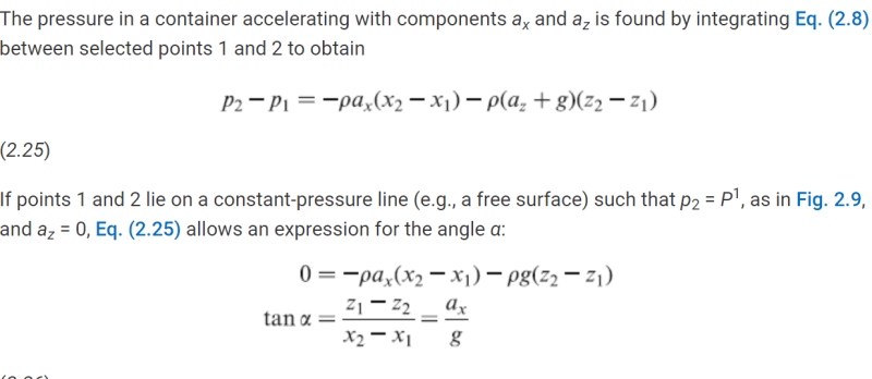

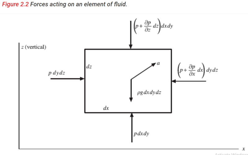

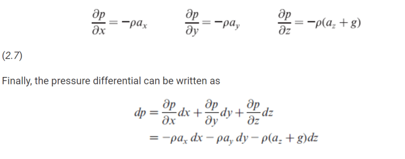

The following are from Schaum's Outlines-Fluid Mechanics:
Now refer the original figure posted by me.
@handleman, thank you for the info. Yes it can be done with CAD. But I was looking for a formula to put it into an equation.
