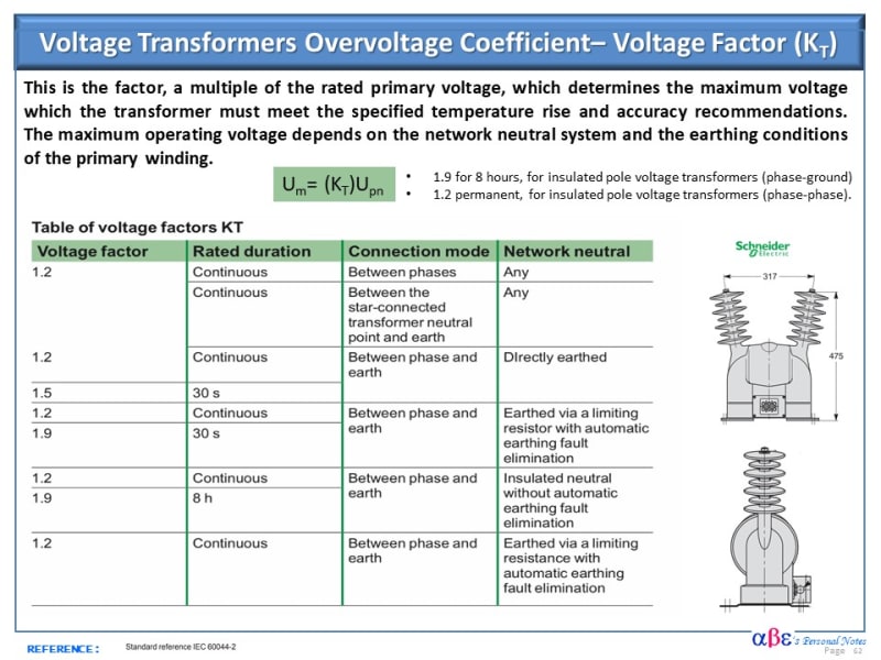

I have seen on PT's/VT's specs, voltage factor 1.2 cont., 1.5/30 sec.
Does it mean the PT/VT can withstand 1.2 times rated voltage continuously and 1.5 times for 30 seconds?

edison123-
Yes, that is what it means.
Normally called Over-Voltage Factor - OVF
See below:
The nameplate value is the nominal system voltage for application. The 1.2 continuous rating allows for 20% overvoltage from the nominal without damage.
The voltage listed on the nameplate should be the Rated Voltage. The OVF is how many times the Rated Voltage the unit can be operated at with a given duration.
