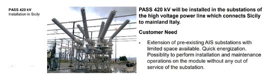

Europe does use hybrid/dead tank compact breakers. These are essentially dead tank breakers with integrated disconnector, earth switch, and VTs. The major EU OEMs all make versions: GE, Siemens Energy, and Hitachi Energy.
I agree with ema157. The so-called "Hybrid Switchgear" are in practice dead-tank CBS with integrated disconnector / earth switch (they can ALSO include VTs and CTs), and they are widely adopted by european TSOs
See, f.i. Hitachi/ABB PASS (up to 420 kV)
https://new.abb.com/docs/librariesp...-day-colombia/reference-pass-ppt.pdf?sfvrsn=2
or GE Hypact (up to 170 kV):

Yes, that was my understanding - that the "hybrid circuit breakers" (such as Hitachi PASS, or Siemens DTC) are in principle the same as dead tank breakers with additional components and are already adopted by utilities. But for pure dead tank circuit breakers (e.g. Siemens 3AP dead tank breaker) are much less commonly seen in Europe, and therefore unlikely to be on the list of pre-approved breakers by TSOs.
