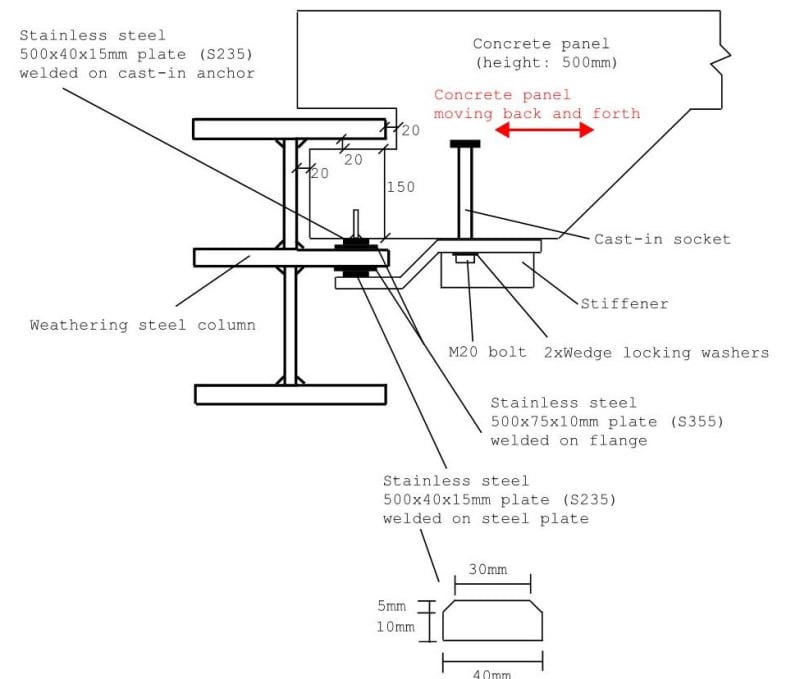

I have a weathering steel column.
1) How to calculate corrosion after 120 years? Any standards to use?

To avoid abrasion, could it be an idea to weld a stainless steel plate on the weathering profile, where it has contact with other construction parts which moves back and forth?

It is outdoor, a post for a noise barriere. Why would you not weld on weathering steel?
I said I wouldn't weld stainless steel on weathering steel, especially not overlap welds to protect the base metal. Not if it is supposed to last for 120 years.

Why is it a bad idea to weld stainless steel on weathering steel? Would you instead weld another weathering steel plate on the main steel column, where the column has contact with another construction part going back and forth?
I think there is no prohibition on welding stainless steel to the weathering steel, if the proper electrode and welding method/procedure are used. But I wonder why you would consider weld these two metals that having completely different appearance.
Welding SS to weathering steel is a bad idea for a couple of reasons.
First weathering steels shed a lot of rust, this will wash onto the SS, and in most places this will combine with airborne pollutants and result in attack of the SS. Another reason is that if moisture is ever trapped where the materials meet the steel will suffer accelerated galvanic corrosion attack.

The concrete panel (see figure) will move back and forth, and grind against the weathering column. How would you make that connection, so that abrasion of the steel column will not occur.
