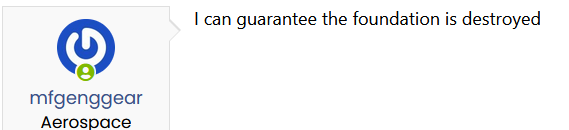

I do a significant amount of work with the local fire department. While a fire can damage a concrete foundation if it burns hot enough for long enough, it is extremely rare for that to happen. I have never seen locally a foundation that had to be removed/replaced/repaired because of a fire. Depends on the local concrete mixture at the time of the original pour, and what is in the building to contribute to fire load.

Nobody said you were. But a bunch of houses in the middle of a nearly 300,000 acre fire are far from indicative of "normal" fire conditions.

Again, we have zero information on the fire. It may have been in a trash can in the front office. Or it may have been in the waste oil tank. We don't know. So it's irresponsible to "guarantee" that the foundation has been compromised without more information. Want to suggest that they investigate the concrete's condition because of what could have happened? Great! But to say "I saw a few houses that were part of one of the worst conflagrations in recent history, so your fire certainly did the same kind of damage" lacks a certain rigor that should be expected of a practicing engineer.
