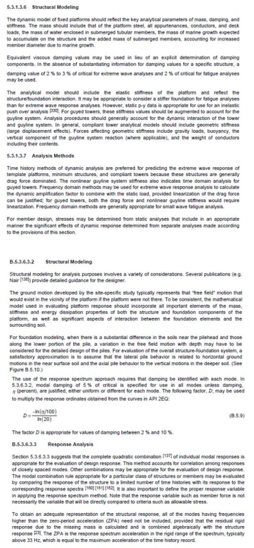

What is your opinion on the damping situation (question #3 in my OP)? Sounds like this isn’t your first trip to the rodeo so I’d be interested in hearing your opinion.
I'm not sure if I have an answer for you. In my experience damping is usually included for dynamic/frequency types of analysis (eg structures applied subjected to accelerations). For the simple structures I have done the hydrodynamic load is applied as a static load representing one point in time during the wave cycle. There are then multiple static load cases representing the different phases as the wave passes through.
The analysis is non-linear but primarily due to the soil/structure interaction. The water surrounding the structure is not usually explicitly modelled. At least, not in anything I have done.
The effect of the pile movement through the water is included in the added mass (mass x acceleration terms) in Morison's equation. Apologies if this is a bit simplistic, in order to move the pile through the water you must also displace the water surrounding it (i.e the force needed to move the pile is the force required to move the mass of the pile plus the force required to move the water out of the way). This extra force is accounted for by 'adding mass' to the pile buy use of added mass coefficients. Although I'm not sure that helps you.

WARose, I have had a look in API RP 2A. Lots of stuff about how to address damping. Our structures are small and subsea so we don't consider it.
Correct. The "outside consultant" called late yesterday and said that wavelength is wrong. (Actually much larger.)
Thanks for the damping info Ussuri.
