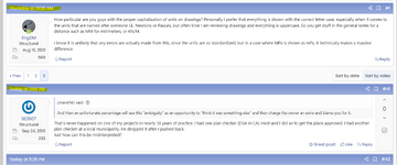

How particular are you guys with the proper capitalization of units on drawings? Personally I prefer that everything is shown with the correct letter case, especially when it comes to the units that are named after someone I.E. Newtons or Pascals, but often time I am reviewing drawings and everything is uppercase. So you get stuff in the general notes for a distance such as MM for millimeters, or KN/M.
I know it is unlikely that any errors are actually made from this, since the units are so standardized, but in a case where MPa is shown as mPa, it technically makes a massive difference.
And then an unfortunate percentage will use this "ambiguity" as an opportunity to "think it was something else" and then charge the owner an extra and blame you for it.
That's never happened on one of my projects in nearly 38 years of practice. I had one plan checker (DSA in CA) insist and I did so to get the plans approved. I had another plan checker at a local municipality. He dropped it after I pushed back.
Just how can this be misinterpreted?

The following may be of interest:
Only one style of charter should be used generally throughout at drawing. ...Upper-case letters should be used. Lower-case letters shall be used for conventional signs and symbols normally requiring such characters, e.g. mm, kg, kPa.
Ex: AS 1100.101 Cl 4.1.5.
I'm afraid that I'm one who insists on a space between the value and the unit. I would use a non-breaking space when the program may re-flow the text.
Most of the world should follow BIPM SI Brochure 9th Edition (2019) clause 5.4.3, which can be found here : https://www.bipm.org/en/publications/si-brochure
The US should follow NIST SP-330 (2019) clause 5.4.3, which can be found here : https://doi.org/10.6028/NIST.SP.330-2019
