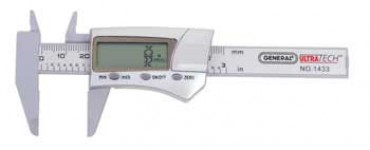

OT but Aircraft Spruce is a great site. I find some unique stuff there. Here is a 3" carbon fiber digital caliper I carry to every job. Only like $15 on that site.
