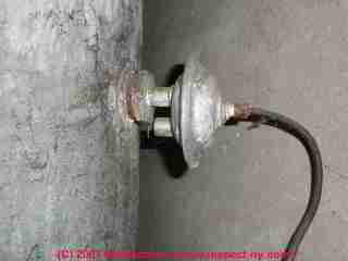

On the subject of the snifter valve.
I must correct myself. What is commonly called a snifter valve in some areas is actually an AVC (Air Volume Control) valve.
The snifter valve injects a small volume of air at each cycle. With a snifter valve it is common to get air discharge with the water out of the facets.
The AVC valve has restrictive porting so that when the water level in the tank is above the level of the valve, the valve works normally.
As the volume of air in the tank increase so that the level is below the level of the valve, the action of the valve is much reduced.
Both the snifter and the AVC do the same job but the AVC does it much better with almost no air sputtering with the water.
An Air Volume Control Valve.

Another thing Keith. There are two types of ACV valves.
One type adds air only when the water level rises above the level of the valve. It may be identified by the diaphragm shape.
The other type of ACV has a works in conjunction with a snifter valve and has a float inside the tank. It works by bleeding of some of the excess air supplied by the snifter valve when the water level drops below the level of the valve.
Neither type of valve needs a a compressed air supply. The snifter valve is ahead of the check valve and allows some air to enter the pump housing when the pump shuts down and drains back and the pressure in the housing goes negative.
The air injecting type of ACV has a pilot line to the pump.
When the pump stops, the negative pressure pulls the diaphragm back and charges the valve with air through the small check valve.
There is a restriction so that very little water is drawn back into the valve.
When the water level is below the level of the valve, there will be some compressed air in the chamber. when the pump stops and the diaphragm is drawn back, this air expands and little or no air is drawn into the chamber.
