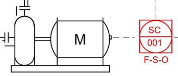

Any suggestions on how to represent control of a two-speed pump (Fast-Slow-Off) on a P&ID? Distributed control system. Something like this?image.jpg
Looks good to me - instead of the abbreviation FSO, spell it out - Fast / Slow / Off.
