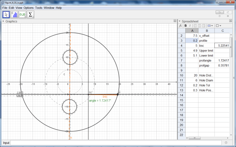

Assume the diameter of datum feature D is 40, and the other flat surface is perpendicular to datum feature B and 7.5 from datum axis A. Datum feature B could be about 5.2278 from datum axis A and still barely meet the profile tolerance, with a deviation of +0.1 at the inside end and -0.1 at the outside end. Bringing this surface into contact with the secondary datum feature simulator would result in an inclination of about 1.72°, and the entire profile tolerance zone would be on one side of the datum feature simulator. Do you agree?
If so, I don't understand what you find problematic about this. To me, it seems a lot better than the scenarios based on "maximum contact" which is never defined.
pylfrm
pylfrm, At this pace it will be a couple of years before I reverse engineer all the diagrams and provide actual mathematical derivations that are correctly scaled. Perhaps it should be a hobby? Will it cause the committee to fix Fig 4-16(b)?
Anyway - here's the Goegebra version to play with: Link
I left the numbers per the diagram and the estimate, which was close to the same offset and does produce the same angle.
What's interesting is the size of the gap at the outer end of the datum feature; much larger than the feature tolerance, labeled profgap:
The number to the right of bsc is the offset of the axis normal to the datum feature B surface.
To better see the contributors, a change of values to be more in scale with the diagram's depiction of the variation:

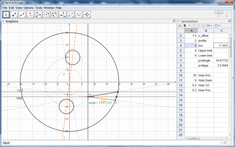

I meant that half the non-rotated zone would be unavailable, not that the part could not be rotated to accommodate it. Essentially, if the part was made in a single operation, such a die cutting, it would require an unusual interpretation, the one you made, to increase the MMB of datum feature B by especially making it non-orthogonal to the nominal location of the holes. If this was investigated before the diagram made it to the standard it should have been in an "or means this" diagram.
I bet that 99% of takers of any test will not understand that the width of datum feature B will affect that 5.2278/whatever value if it was one of the multiple choice answers. The misrepresentation through optimistic simplification is what I am complaining about.
Pushing the offset to -4, the other side of the vertical, nets this:
