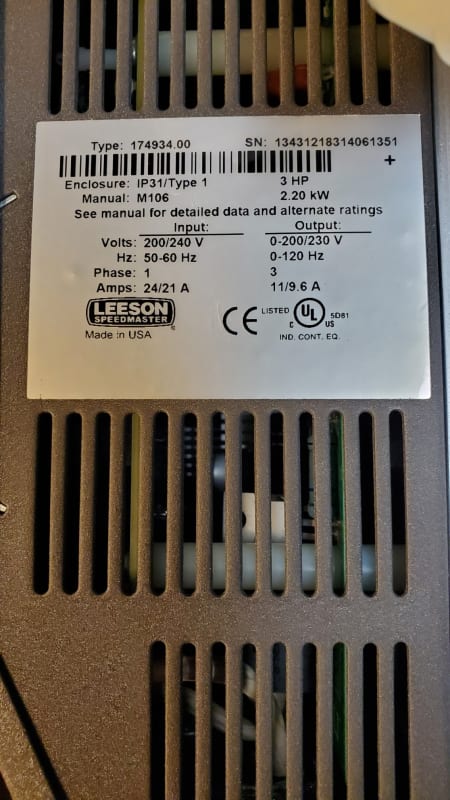

Most VFD mfrs offer a version up to 3HP (2.2kW) 240V that are pre-designed for a single phase input, meaning no doubling of the HP is necessary. They are all inexpensive.
Beware of impossibly low pricing, there is always a reason. I am of the opinion that you can get very good name-brand products at very reasonable costs, but if you go for the lowest cost “no name” drives from China sold only through on-line sources, you will be exposing yourself to the risk of getting some real junk. Also, beware of used drives, also sometimes impossibly cheap. If a drive sits on a shelf unpowered for 2 years or more, they need specialized attention to avoid being damaged just by applying power to them. You have no way of knowing how long a used drive has been sitting around.

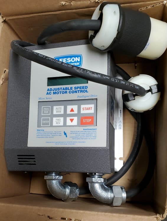

Note the smaller drives
Actually, I have an old NEW drive you can have. Pay for the shipping and it's yours with caveats. I have never powered it up. You would definitely need to re-form the capacitors by powering it up for 24 hours before ever loading it in any way. There is a small but finite chance the caps would pop. If they don't it would work for you.
