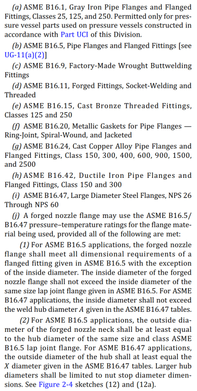

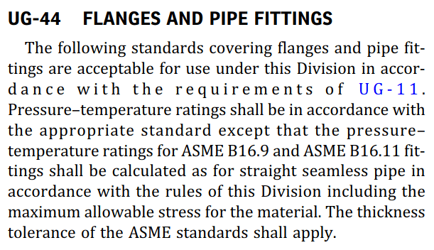

Since posting I re-read my notes. Am I right in thinking that UG-44 prohibits the use of any pipe fittings that are not among the listed ASME standards?
It does not. Manufacturers standard parts are permitted. This subject has been discussed before. As I recall some manufacturers certify their fittings to Sec VIII, Div 1. Try a search.
