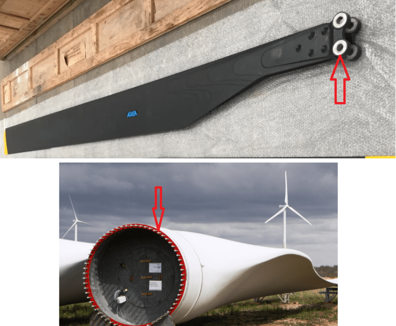

Hello all,
Imagine a carbon-fiber rotor blade that is manufactured by laminating the layers on an inner mold, and cured inside an outer mold that will determine the outer, complex aerodynamic surface. The blade is then trimmed at the root and at the tip, forming two planes that, theoretically, are perpendicular to the span direction. Then a pattern of holes is drilled; each hole's axis is normal to the outer aerodynamic surface, so each one has a different direction.
What would be a correct way acc. to ASME Y.14-5 (2009 or 2018) to determine the position and the form of the trimming planes and the hole pattern? In principle, the 3D CAD model is leading, but my company still wants tolerancing on 2D drawings.
I thought of defining the whole outer surface (excluding the root and tip planes) as a datum feature A. According to Fig. 4-3g (2009), that should restrain the 6 DOF; am I correct?
Then the root planes could be defined with a profile tolerance without any reference, their theoretically exact positions given by the 3D CAD model.

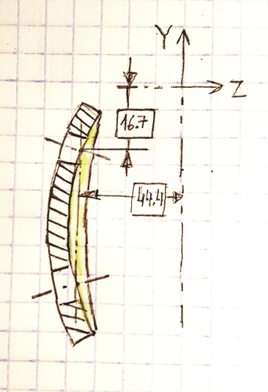

But the pattern of holes is more problematic. Their axes are not parallel to the root/tip planes. The only way to unequivocally define their position is in the 3D CAD model. Can I just give their positional tolerance referenced to datum A (meaning that the holes are normal to the surface), without any TED? Would I need to define a coordinate system and use it to position the holes with TEDs, as in Fig. 4-28 (2009)?

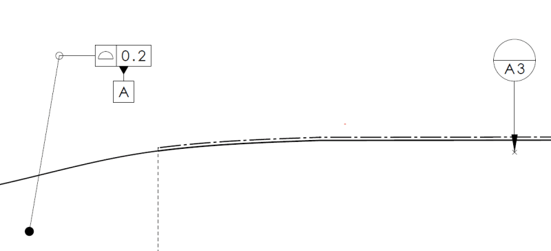

By the way, in Fig. 4-28, what does the lower profile tolerance in detail A point to? It looks like a very thin edge, but I have no idea what it is exactly.

Yes, I agree that Fig 4-28/7-29 appears to be cylindrical rather than spherical. I don't think this really matters though, since I believe the intent, whether it is cylindrical or spherical or any other shape is to have datum feature A will behave like a planar datum feature.

For now, giving up on using the aerodynamic surface as a datum feature, suppose I define three datum targets A1, A2, A3 on that surface. They would determine a datum plane A. Datum plane B would be defined by the trimmed root plane. How could I define the theoretically exact position of the pattern of holes in that case?
All the axes of the holes are parallel to datum plane B, so they could be positioned with a TED to it, but each hole has a different angle w.r.t. datum plane A. Even if I somehow indicated the angle of each hole to datum plane A, I would still need to constrain another DOF for each hole, but I don't have another datum feature that I can use for that.
Well that doesn't sound like giving up on it**, but its not typically clear what kind of datums are derived from several out of plane datum targets A1, A2, A3 (though I can say it likely isn't just a single datum plane). Its not even really typically that important, especially with datum targets - you define your theoretically exact location/orientation of the feature(s) of interest with basic dimensions to each other and to your datum features (and your targets relative to each other if utilizing targets) and ensure your DOF are constrained properly by your specification of datum features/datum targets. These datum features do not have to be (and in many cases - should not be) the surface(s) (or datum targets coincident with the surface(s)) from which the pattern of holes originates.
Then I no longer understand your previous statement on this:
In 4-28/7-29 datum feature A could be spherical, so a customized DRF may not be needed.
I may be missing something here, but if it could be spherical or cylindrical and the intent is that it acts as a planar primary datum feature, shouldn't the degrees of freedom constrained by it be clarified by a customized datum reference frame, here too?

Your primary datum, established using datum targets A1, A2, and A3, will constrain 2 rotations and one translation. The trimmed root planar surface is assumed to be nominally perpendicular to the datum plane established using A1-A3. It will constrain the final (3rd) degree of rotational freedom, and also one translation. My concern is that it may not be a sufficiently large surface to constrain that rotation in a repeatable way.

Yes, I should have said that differently. It does not matter what the shape of the non-planar datum feature A is. It clearly appears that the intent in both of the figures is that A provide the same constraints as a planar datum feature, so a customized DRF would make sense for both figures.
