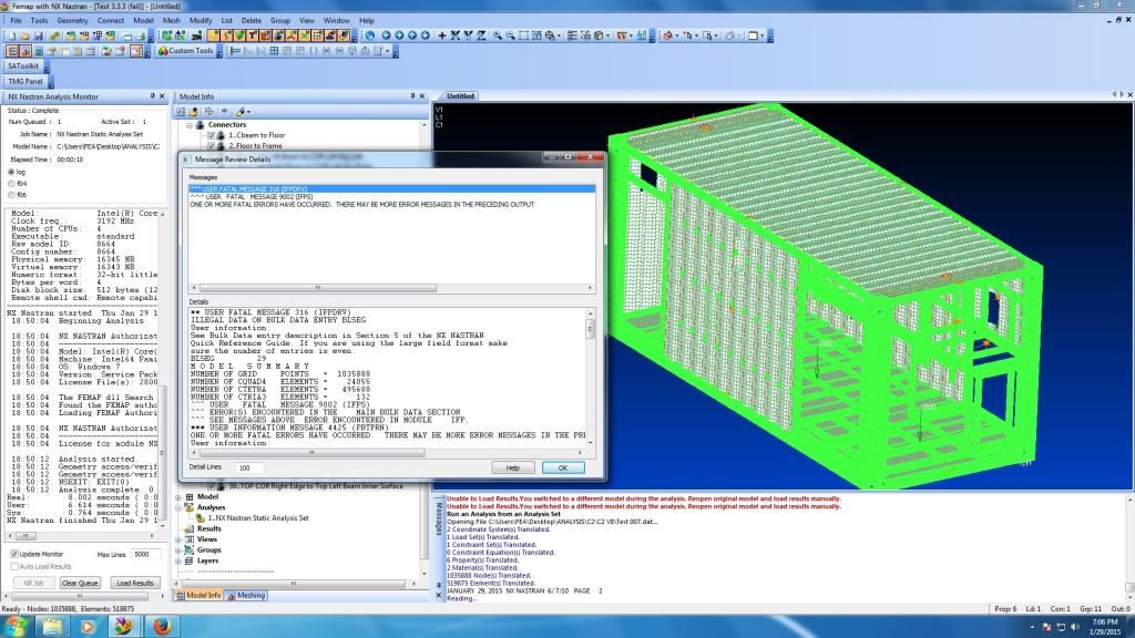

Hi Guys,
I am trying to do some analysis for my container structure. Everything is working out fine until I hit the user fatal error 316.
User Fatal error 316
BLSEG
I have try to rearrange my gluing target, master and source but no avail.
PS. I cant upload my meshed files as it is too big and unmeshed file(unknown reason).
Dear Matt,
Open the nastran *.dat file using any text editor (for instance, wordpad) and search for BLSEG and hitting NEXT go to BLSEG#29, surely the line is empty, then the error (you should see a list of grid nodes). This happens if the mesh is not associated to the geometry used to create the edge region. Also, revise the EDGE REGION#29 to check that everything is defined correctly. In any case in FEMAP issue the command "MODEL > ANALYSIS > PREVIEW INPUT" and check that not any RED message appear!!.

Sorry for the late reply.
Thank you very much Blas. You are the best. I managed to solve it.
