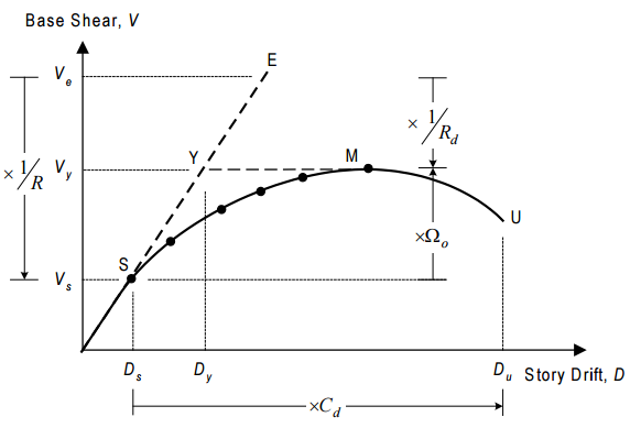

I can shed a little more light on this. At least... I think I can. In Canada, and many other countries, we have two R factors:
1) Ro (over-strength, 1/Omega) which accounts for the base shear differential between the point of first significant yield and the point where the entire structural lateral system is thought to have given way.
2) Rd (ductility) which accounts for the base shear differential between the spot that Ro gets you to and the R=1 demand level.
The sketch below does it better justice. In the US, Rd and Ro are combined into a single R factor. Anyhow, the moral of the story is that you only have to amplify by the Ro (Omega) to roughly ensure a member's elastic behavior. R=1 is indeed over conservative. I apologize if I misled you in that regard earlier.
KootK -
That is my favorite diagram for explaining seismic concepts. It explains why we have R, Cd and Omega all in one simple force deflection curve.
KootK, Thanks for the graph. Good to know that's how other codes handle the difference between Omega an R. Is the graph truncated? What is the Base Shear value corresponding to Du?
In ASCE the Cd value is somewhere between Omega & R. Where Cd is closer to R value for more rigid systems such as walls, and Cd is closer to Omega for more flexible systems such as cantilever columns. Kind of make sense to me that in a rigid system, the element is more likely to experience ground acceleration, or R=1. If my logic is correct, the ASCE Cd value assumes that SMF (Cd/R=0.688) is more flexible than OMF (Cd/R=0.857). Which brings back my original concern that if the plastic hinges do not develop in SMF, then should we calculate the drift based on the SMF Cd & R values, especially when the SMF design is drift controlled.
Yes, you need to calculate drift based on whatever R value you used because you are reducing the seismic load on the assumption that the energy will be dissipated by the formation of plastic hinges.

The graph pertains specifically to US codes.
Nope.
I don't know. I'm not sure that anyone does really unless testing or at least a pushover analysis has been performed.

I observe the same trend but interpret it differently. With a flexible system, much of your R will be comprised of Ro (omega) and relatively less will be Rd(ductility). That make sense since a moment/cantilever frame will sustain relatively little damage at peak inelastic displacement. Thus Cd close to omega. With a wall, it's the reverse. Lots of damage at peak inelastic placement and thus a Cd value better correlated with Rd or R.
Kootk,
Thanks for the chart and explanations. I wish I had see it / read them years ago.
You're most welcome Archie. I've always found getting good explanations for seismic code intent to be excruciating. It seems as though one could sum it all up in one good 10 page white paper but, as far as I can tell, no such document exists.
