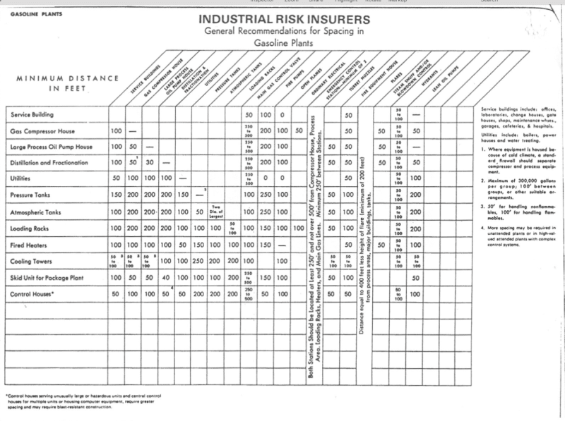

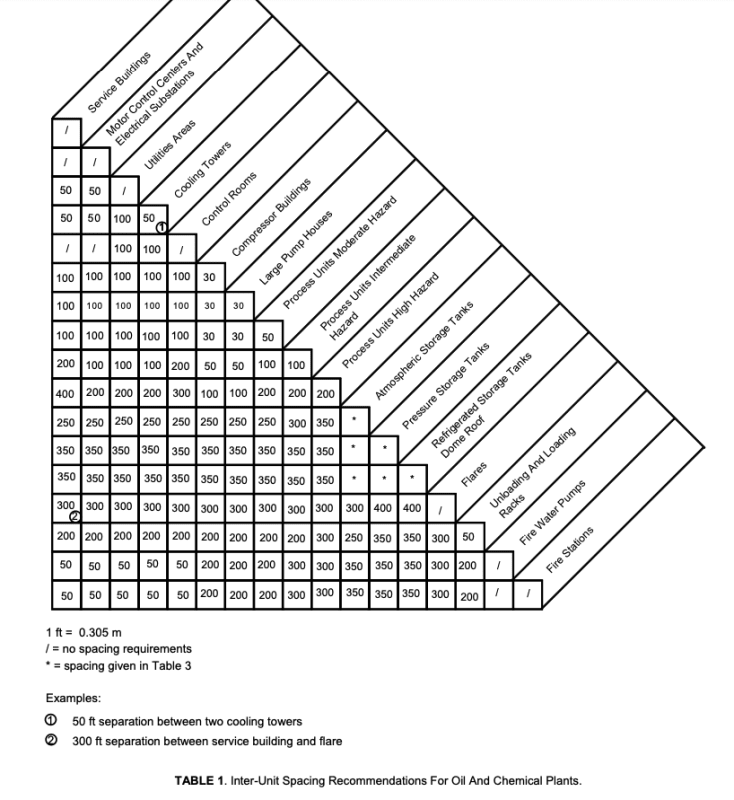

Recommended industry practice based on long-standing insurance guidelines - GAP 2.5.2 Oil and Chemical Plant Layout and Spacing, although for production properties there was a slightly less restrictive guideline
no longer published - "Gasoline Plants - Recommendations and Guidelines".

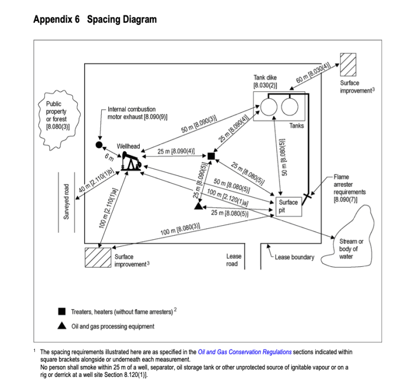

I should add that the majority of oil battery type production properties just follow the local state or province petroleum regulator's minimums. e.e in Alberta:
retired, technical library for sale on eBay -

1) No idea - probably some company guideline or Process design book. good reference? You could use hazardous area guides or any number of guides like those mentioned above if you have most of Texas to layout your well site.
2) You can't. There are so many guides and prescriptive distances that unless your AHJ has one you could choose just about anything you want.
3) Rules are legislation - look up your area. In general put storage tanks down wind of fired systems and get as much distance as you can between them.
If you've got a bund around your tank then most Hazardous area classifications go to the edge of the Bund.
But if you've got 25m of distance and you can stop liquid getting to the heater treater if the tank fails then you should be ok. But look out for the wind.
