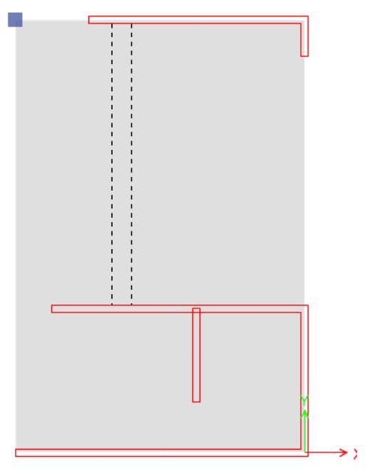

So I have simplified my model to make it easier to look. I am using ETABS for this building and use its export feature (loads above and floor) to SAFE to design the transfer slab on first floor.
I then found this weird thing, though the internal transfer wall is in compression in ETABS, the left hand side node loads in SAFE are uplift and thus the deformation is uplift under transfer loads.
Can anyone please help explain what cause this? Is this normal? What do I need to do in ETABS before exporting floor and loads from above to SAFE for me to design this transfer slab? Thank you.
(I don't know how to upload models so I have uploaded pics as below, much appreciated if anyone can let me know how to upload model files too)

It looks like you have uplift due to lateral in-plan loads. the slab is seeing that load, so it needs to resist the load
Without having more information, here are two suggestions:
1. As suggested by Eric, the uplift is due to the wall above (long in the X direction, approximately at the centerline in the Y direction) resisting lateral loads in the X direction, and the associated overturning of that wall imposing uplift the larger span of your transfer slab.
2. Perhaps a cardinal direction error between SAFE and ETABS, where down-loads in one program are interpreted as up-loads in the other? I don't do much of this type of work and do not have familiarity with the programs, but it is a potential whenever importing/exporting data from one software package to another.
You have irregular arrangement of support (center of rigidity), and with an opening direct below, uplift is possible at the left upper corner.
Because it is a 3d model the slab below the long wall in the middle is too soft so the upper slab acts more like a single span to the outer walls and the short walls near the lower supports. This puts more load in the first span and less in the long span which yields the uplift.

No, there is no lateral loads assigned. Just dead load and live load.
This makes sense. So if the layout cannot be changed, what should I do in Etabs before exporting to SAFE to make the transfer loads 'normal'? ( I don't think I can use the above 'weird' loads to design the slab directly, can I?) I have tried to revise the stiffness of walls but doesn't make much difference.

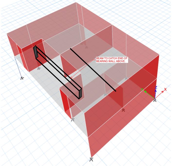

First, let's celebrate your model. It's revealed some accurate and vital information to you: the original structural scheme for this building is lacking. Were it possible to do so, I feel that the simplest path for rectifying the situation would be adding the beam that I show below. I recognize you're desire to maintain the original layout, however, so I'll not belabor the "back it up and make it better" option. Rather, I'll answer your specific question about how to adapt you model. Keep in mind, however, that both approached that I recommend will wind accomplishing the same thing: providing stiffness that the beam below would do a better job of providing.
Model Fix #1
1) Model the upper floor by itself and record the reactions at the bottom of the walls.
2) Model the lower floor by itself and load it with the wall loads from #1. When you do this, be sure to adjust your slab proportions such that reasonable transfer slab deflection limits are enforced. Limits to the tune of the lesser of 1" max anywhere or L/400 at a minimum. Enforce these limits on long term deflections that account for creep and concrete cracking.

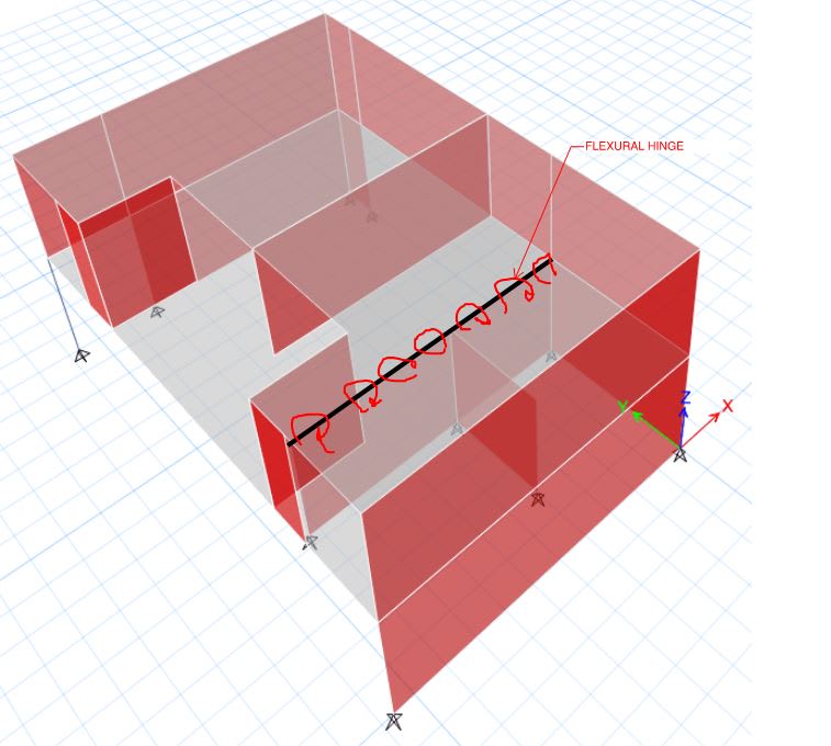

Model Fix #2
3) Model a flexural hinge in your slab where I've shown it below.
4) Design your slab in SAFE being sure to adjust your slab proportions such that reasonable transfer slab deflection limits are enforced. Limits to the tune of the lesser of 1" max anywhere or L/400 at a minimum. Enforce these limits on long term deflections that account for creep and concrete cracking.
5) Come back and put some nominal crack control reinforcing over top of he wall where we assigned the flexural hinge.
Thanks KootK. I wonder what location is this beam going to be? because looks like you are connecting the beam to walls above not below. (I reckon you thought these two walls were at lower level and arrange a beam to pick up the middle wall above?)

Model the flexural hinge if ETABS? may I ask why place a hinge here to let it crack considering the moment in slab is not much at this area?
The beam is meant to be connected to the walls below. The beam would be integral with the the second floor slab. as shown below.
5) The purpose, when combined with appropriate deflection design, is to encourage you to provide the stiffness mentioned in (2): a stiffer slab over the long span.

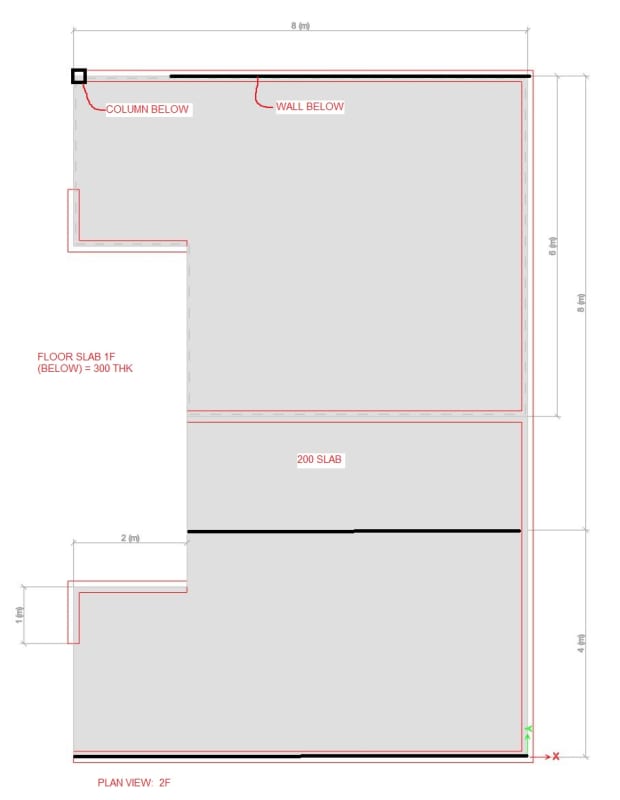

I opened your model and I do not see any section modifiers for the bending stiffness. I assume this will be conventionally reinforced. You need to look at the deformation of the structure carefully to ensure an appropriate design. How much the 2nd floor deforms may have a significant impact on the design of the 3rd.
Below is a plan view sketch of the span arrangement for others: dimensions in meters
