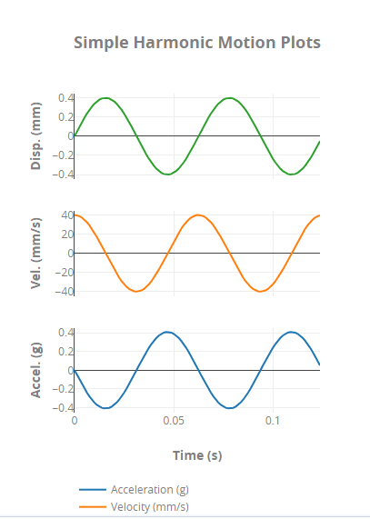

The maximum displacement of the beams under this dynamic load is 0,4 mm according to the analysis.
Whoah... Hang on a second! Have you thought about what 0.4mm means at 16hz! If I'm not mistaken, 0.4mm is quite significant. Try viewing the results in terms of acceleration rather than displacement.
Your displacement results are quite similar to my calculated displacement results in the other thread where the vibration was extremely 'severe'.
I don't want my floor or structure experiencing accelerations of 4m/s^2! These values where of the order I measured in the 'severe' case previously mentioned.

As for the displacement 0.4 mm, that is huge. I would be more comfortable with 0.4 mm/s [smile]. Are you sure about that calculation?
ThomasH said:
As for the displacement 0.4 mm, that is huge. I would be more comfortable with 0.4 mm/s smile. Are you sure about that calculation?
I'm not sure whether you were question me or the OP here. The OP calculated values are 0.4mm as stated. My calculated values in the case of the existing installation was of similar magnitude.
I'm also sure about my measurements. In some locations the measured floor acceleration was 1.5g RMS with max observed at 3.0g. As already mentioned these vibrations could be seen, felt and measure over 50m away through the earth.
I apologize, that was far from obvious [smile]. I don't question your harmonic plots. I got the same results.
But I find the results so high that I wonder if they are correct, question for OP. If they are correct I believe the design needs some modification.
