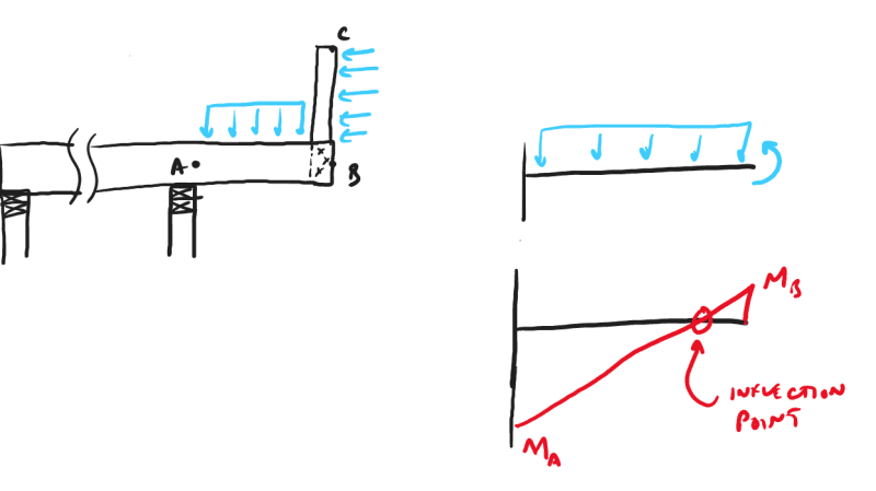

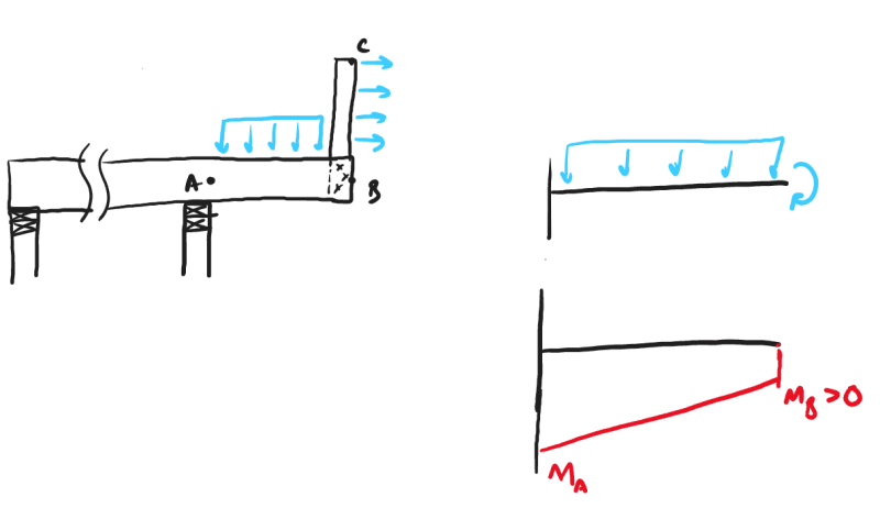

For one thing, the end of a cantilever is not always a point of zero moment, though it often is:
And for another, the cantilever end won't have an inflection point unless you apply a moment to the end that is in the opposite direction of the bending moment from a uniform load:
So if you were to select that woodworks option, it would only mess up the analysis of a cantilever for a unique case like this one since most cantilevers do not have inflection points. But it would screw up all sorts of continuous beam analysis models where it would see the unbraced length as significantly less than the actual unbraced length.
Shouldn't these bending moment diagrams (the red lines) be nonlinear instead of linear?
@hoshang, The thoughts/messages delivered by the rough graphical representations are clear and have been delivered through. Good enough.
