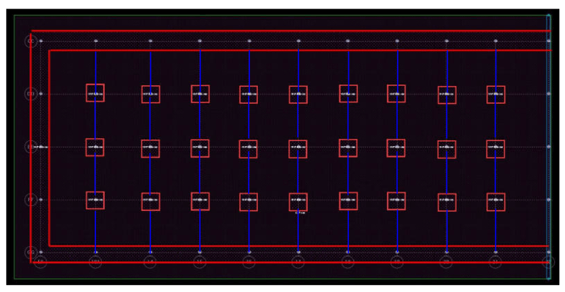

I am looking at an existing two way concrete slab with drop caps from the mid 60s that has one direction very heavily reinforced - good for 2x the stated design live load - while the other direction has much less reinforcing and doesn't quite achieve the stated design live load. I am using RAM concept for this analysis right now. Is anyone aware of an different analysis method for these systems they may have used? I would be surprised if load can be redistributed the other way, or that treating one direction as a one way slab supported by the stronger bands would change things too much, but maybe I am off with that thought.
The odd thing is other floors in the same structure are reinforced as a more conventional two way system, with similar bars each way.

The reinforced topping idea would work but but could get expensive, especially if the added weight triggered foundation upgrades.
Another alternative might be to introduce beams such that the system could be analyzed as being truly one way. The Achilles heel of such a scheme, however, is surely the existing services running below the slab. That said, if those services must remain, there might still be a way to pull it off:
1) Something akin to the stub girder setup.
2) External post tensioning.
3) Make the "beams" concrete curb-ish things on the topside hidden within a raised floor (also not cheap).
You'd want a pretty stiff beam to get this thing acting convincingly one-way.

Assuming the rebar layout and concrete is relatively well known, and the project requires only a nominal load increase this seems an excellent case to retain someone like Vector Analysis Group to a detailed NLFEA analysis to understand the real slab capacity. Analyzing 1/4 or 1/2 of the slab shown using NLFEA is not complicated if you know how to do it, and have the software.
I would add the option of carbon fiber reinforcing to Koots list if the load increase is not that large. In my experience the added thickness option leads to architectural problems at stairs.
How has the slab performed to date?
