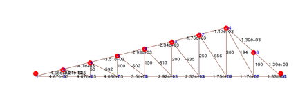

Back to the 15:1 truss.
Here's the member force diagram for a 45x3 pin jointed truss that looks vaguely like the original, with 100 load units applies vertically to each node along the top members, reacted by 400 at each end
ie ca 10:1 load magnification in the end bay, as you'd expect, note that the first vertical in particular plays no part in this load case.
The diagonals and verticals are very lazy (that's what I was interested in).

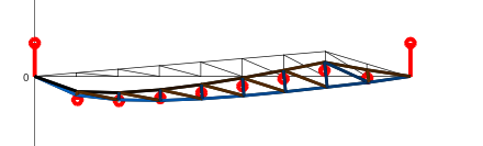

Here's the deflected shape (the loading is shown by the lollipops).
Better hope it doesn't snow! The Cremona diagram needs to be drawn on a roll of wallpaper.
A couple of shear panels on the 3 bays on left hand end would cheer things up.
@GregLocock beautifully done.
That's exactly what I was getting at with the low Ix_truss to Ix_chord ratio. The left hand side of the thing starts to act like a pair of beams rather than a truss. I suspect this is also why the bottom chord is larger than the top which is unusual for these things.
