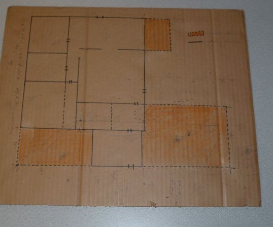

Jumping back to the sketches and what passes for "plans" for a minute - Sometimes we're the only design professional on a job. Which means we have to be the bad guy and enforce some of the things that you guys also do.

Hol’ up…someone submitted a plan on a piece of cardboard…without any dimensions…or notes on it. This can’t be real. If this is all you need to do then I’m doing like 1000% too much.
DayRooster - if you look reallllly close, you'll see somebody did scribble some dims and notes on. Maybe with a pencil? But yeah. That's kinda bananas. I've heard tell of the rather 'loose' rules that exist in the rural mid-west...but I hadn't actually seen proof of it until now. I'm sure there are places not far from me where similar shenanigans go down, but it's no less shocking.
Granted...I did have a shop drawing submittal from a fabricator (railings, I think?) on a piece of notebook paper ripped from a spiral notebook, drawn in a way that would leave my 5 year old plenty to critique, and emailed as a picture taken on the guy's phone. So...it happens.
DayRooster - Yes, it is very real. That's the kind of thing I deal with on a daily basis.
