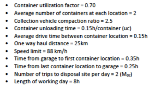

SW from commercial area are to be collected using a stationary-container system having 5 m3 containers. Determine an appropriate truck capacity for following conditions:
Truck capacity is generally expressed in Lbs or Tonnes.
There is no specific weight given for the waste nor any indication of the mass or volume to be transported each day.
No indication of loading time.
The problem is unsolvable as stated.

Considering this is a school problem, there is sufficient information to solve it. Truck capacity will be in m^3. Not the best, I realize, but still valid. The OP's second sentence and the first three bullets give compacted volume per stop. I assume the unloading time is included in the other times (a simplification for the purposes of a school problem), etc. The only real unknown to me is whether the speed limit on the run to the disposal site equals the actual speed. In real life it won't, which is why I suggested an assumed lower speed for these runs. I solved the problem yesterday in about five minutes. It's not a difficult problem.

5 m3 containers
Container utilization factor: 0.7
Average number of containers at each location: 2
Collection vehicle compaction ratio: 2.5
Unloading time:
Drive time:
Distance:
Speed limit:
Time from garage:
Time from last container:
Number of trips to disposal site per day: 2
Length of working day: 8hr.
Raw volume of waste = 5 containers x 3m = 15 m^3
15 m^3 x .7 utilization = 10.5 m^3
10.5 m^3 / 2.5 compaction ratio = 4.2 m^3
4.2 m^3 / 2 trips per day = 2.1 m^3 truck capacity.

Please recheck your volume calculation. Each site averages two containers, each with a volume of 5 m^3, so 10 m^3 capacity per site, then apply the utilization and compaction factors.
Then, you still need to figure out how many sites can be serviced during an eight hour day. With two trips to the dump each day, the truck capacity is based on two four-hour half-shifts. Figuring out the number of sites is where all the time elements in the problem statement come into play.

There's still missing parameters/assumptions, like:
> do you have to go back to the garage before you go to the dump?
> Is the dump the same distance to the first location as the last?
> how long does the truck stay at the dump, i.e., long does it take to dump its load?
Since this is not mentioned, it is reasonable to assume no.
Since only one one-way haul distance is specified, it is reasonable to assume the same distance.
For my solution, I assumed time at the dump was equal to container unloading time. This is unrealistic, so is a legitimate unknown that I missed.
However, it is important to remember that this is a school problem and school problems are typically extreme simplifications of the real world. Their purpose is to teach principles, rather than attempt to solve a real-world problem.

Sure, I got that, Fred, but these are things that certain TAs potentially downgrade, for not stating what the assumptions the OP might have used, and that might have been the intent of the problem, particularly since college is where one should start learning that problem statement often don't contain all the required information.

Agreed. That's why I initially suggested making an assumption regarding average speed to and from the dump that was some fraction of the posted speed limit. That being said, there is enough information and HINTS (which I should have added above) in the problem statement to create a solution.
