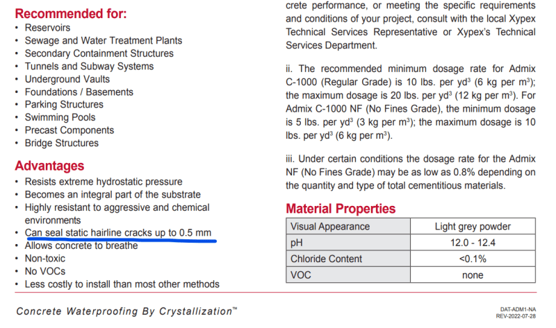

I’m designing a pool and planned on using an external waterproofing membrane but the construction team that has built similar pools in the past advises instead suggests using an integrated crystallizing waterproofer in the concrete. However, the crystalline waterproofing's manufacturer's says that it can only waterproof cracks up to half a mm wide. I’m not too confident in that recommendation. Do I just drop the waterproofing membrane altogether? I’ve seen companies like eco finish ( are offering pool finishes that act as waterproof barriers, but I’m not sure how effective they are. If anyone has any ideas I’d appreciate it.

Typically you make the concrete waterproof with two strategies. Use enough rebar to limit the width to 0.2 - 0.3mm and then use a admixture that works for cracks up to that width. Kryton and Xypex both have similar products. The C-1000 limitation is shown below. A membrane works too.
Autogenous healing works anyway up to about 0.2mm-0.3mm doesn’t it?. Especially in pools. What advantage do the admixes give?
Advantage to the admixture manufacturer. Snake oil. Like Tomfh said, autogenous healing will seal "static hairline cracks". Fancy cements are not needed when good old Portland Cement is doing its job.
I thought that autogenous healing was up to 0.15-0.2 and works more slowly. Admixtures speed up the process and go up to 0.3. But that also may have been a brochure from an admixture manufacturer.
I just looked this up. It seems the admixes do provide real additional benefit beyond regular autogenous healing.
