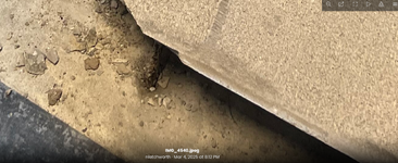

My name is Nicole and I am hoping someone can help me. We attempted to build an above ground lap pool on concrete. The pool measured 75 feet long, 7 feet wide, and 4 feet deep. We had a liner to hold the water. The rear of the pool and the right side 75 foot wall was the structure of the building (see pictures). The left 75 foot wall and front of the pool were cinderblock that had rebar every 16 inches and then each hole was filled with concrete. We hired a certified contractor to build the wall, and it failed. Now, we think the wall was not supported enough because that 75 foot wall had no supports down that 75 foot run at all- only the rebar. The wall completely fell over in one piece once the pool was about 4 inches from full, so it fell top heavy. See images, it cracked on the corner and it was a horrible mess!! We have now gotten rid of the mess and want to give this another go! We already have this building and do not want to make the lap pool outdoors- we want it in this building.

Yes the anchorages to the slab failed and the wall fall over. With DIY pools, deep poles, or lots of braces are the answer.

A structural engineer absolutely should have been hired.
The specs and the condition of the slab are not known so I could see an engineer not putting his stamp on this.
Just from the pics the "tie in" to the slab does not look proper. That wall falling over is a catastrophic failure.

Well, either the rebar yielded or their was anchorage failure.
Bars don't stretch that far. The anchorage failed. If there was any grout in the block around that bar, it wasn't much. If the cells were grouted at all, it was probably accomplished by dumping into the top of the wall after it was built to the full height, without any vibration, so little of the grout got down around the bar. Not enough broken grout around the bottom of the wall to indicate a cone failure. Likely it's mostly void space around the bars. A freestanding wall might survive that way, but not one with 4' of water pressing against it.
