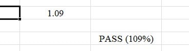

lex said:
Well, 14.06/13.81 = 1.018, I suppose there's a truncation in the guts of their code, so when it chops it off to 1 decimal it's a 1.0 and passes.
The software states "1.02", meaning it rounded 1.018 up to 1.02, as opposed to rounding it down to 1.0.
Some people and some software consider 1.02 or 1.03 a passing value. This isn't a case of the computer failing to recognise that 1.018 exceeds 1. Rather, the PASS/FAIL threshold is set slightly above 1.
The display logic does not need to match the internal logic of "pass/fail". That's what you're misconstruing. This is a printout, not the program code, so you can't tell what it's doing behind the curtain.
The computer is capable of distinguishing between 1.0, 1.018, and 1.02, as is clear in the display output. The software is simply calibrated with the PASS/FAIL bar set slightly above 1, as some people are known to do.
Just Some Nerd said:
Imo some people and some software need to re-assess what they're doing....
I don't agree with it either, but it's what some people do.
It's not 1.0, it is 102%. The 1.0 is a Canadian code reduction for load duration factor and it just displays it so you know it is used. For instance, with high-ish dead loads on wood members that have snow and live loads, the LDF can go as low as 0.7 so your capacity is 0.7*factored capacity.
You both are getting confused here, I'm saying it's a "pass" because the logic on the pass/fail is separate from the capacity calculation, for whatever reason, INSIDE the software. I'm referring to the "PASSED (102%)" - the pass fail that displays "pass" isn't using the calculation to the right of it (102%, It's using some other internal logic.... it's a bug in other words due to sloppy coding).

EngDM - it's a coding error, report it to Forte.
I'm not confused; I simply disagree with your claim that the only way software could PASS a value of 1.02 is because of a “bug” in the software. Many engineers and various pieces of software intentionally pass values that slightly exceed 1.0. It’s no accident.
It’s relatively common practice, and whilst questionable, is an entirely different scenario to a structure that’s overstressed 50%+, 100%+, 200%+, etc. For the whistleblower engineer to have hit the panic button the level of overstress must have been in that sort of range, as opposed to 2-3% over.
I doubt the fellow in New Brunswick is upset about 102% I'll grant that.
I think it's a bug because I've never had Forte do what the output shows, pass with over 100% on the check. Can't really share Forte data files anymore with the web version.
Yeah I was going to say I see this in Forte all the time. especially, when checking existing framing. There are plenty of times you'll see 100-102% as PASS in green. But I make sure any of my calcs or designs are passed at 99% or [well] below.
