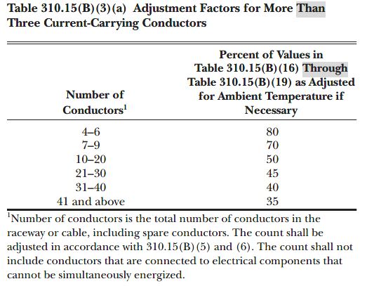

Per the sketch below, can someone confirm these cables only need a 0.80 de-rating factor (Table 310.15(B)(3)(a) since there are 4 carrying conductors per cable (DC application, 2-1500V+ and 2-1500V -) as long as 1" cable diameters are spaced at 1" intervals via intermittent plastic cable supports for spacing? Tench length will be double lane (so estimate that at 24 feet. Then, a vented cover can be used.

Thanks 7anoter4. But Table 310.15(B)(3)(a) is required to be taken into account, as all references in the NFPA 70 for conductor ampacities for 1/C or 3/C. This is why the table is entitled "...More Than 3..." Since there 4 current carrying conductors we need to de-rate the cable by at least 80%. In this scenario, I am looking at 4-4/O conductors with ground. 2 Conductors for (+) and 2 are for (-).
Sorry 7carifast but the Table 310.15(B)(3)(a) is referring to Percent of Values in Table 310.15(B)(16) Through Table 310.15(B)(19) only. Cable ampacity in duct bank are in Table 310.60(C)(77) through Table 310.60(C)(85)[and for cable with rated voltage from 2000 to 35000 V 60 Hz ]. The only correction permitted for these tables is for Burial Depth of Underground Circuits. For cable above 2 kV rating in AIR a correction factor for air temperature different than 40oC is permitted.

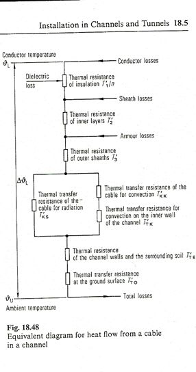

Following Siemens publication: Power Cables and Their Application, 3rd Edition by Lothar Heinhold/Reimer Stubbe (Editors) chapter 18.5.1 Unventilated Channels and Tunnels the problem may be divided in two parts.
The first part is the individual cable heating calculation [in air, as usual: this according to Neher&McGrath theory or IEC 60287] and second part the closed air heating. The second part is presented in Siemens above publication and schematically so:
An approximate calculation for 18 cables of 4*#3 copper conductor EPR [90oC rated] at 110 A
the air temperature was 79oC and the conductor 90oC.
Revising the calculation program for 4*#3 copper conductor XLPE insulated and PVC jacketed cable
in a 20*12 inch pre-casted trench in earth of 100 RHO and 30oC top earth temperature, covered by 200 mills steel plate, 3 rows of 6 cables in each row the air steady state temperature was 51 oC at 94 A per conductor.
