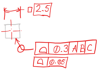

similar is probably answered somewhere, but can't find it.
Working with ISO, is it possible to control true position (derived median line) of a square pin with only 1 characteristic like it's done with round pin?
Or, the only way is to tolerate it in each side?

Now, speaking about ISO, probably one solution could be:
Profile all around 0.3 CZ to A|B|C| collection plane perpendicular with A
However, my proposed solution could / would not control derived median line as requested yet controlling the surface.

Now it's my turn to apologise. @Andera, others, forgive me I have a lot more to learn. I missed it with the term derived median line, I actually have in mind intersection of 2 derived median planes. I know I'm asking a lot. Jesus, is there even term in ISO GPS for that?
Can you elaborate, what do you mean with "collection plane perpendicular with A"?
Isn't "all around" and "CZ" conflicting here?
Feel free to "give me a lesson" on this one. You know, my primary job is playing soccer, engineering/metrology is hobbie only :D

Seriously, I think Andera is correct (to the best of my knowledge) and collection plane indicator must be used if all-around profile (as proposed by Tarator) is used.
See this discussion and specially the posts from pmarc. (the best GD&T ISO expert this planet Earth has).

As an extension of principles, you could draw a circle circumscribed about the square pin and apply single position tolerance directly to it. The position tolerance value would then be followed by (N) modifier, for example, that would indicate that the toleranced feature would be the associated minimum circumscribed cylinder and the axis of that cylinder would have to fall within the tolerance zone.
The approach would have some downsides, though, one of which would be the lack of orientation control (free rotation) of the square relative to datums B and C. To adress that, an orientation tolerance for at least one side of the square with respect to B or C would have to be defined anyway. Unless you would be OK with the free rotation of the pin.
I am learning alot from your postings here and I would like to ask (just for my own education) for this square pin, is it legal (or valid) to use the (X) modifier to indicate the associated maximum inscribed cylinder? Or such of approach for an outside feature is forbiden by any ISO standards (because is reserved for an inside feature).
I appreciate your support.
Andera,
Per ISO 1101:2017: "NOTE Although the X specification element is usually used for internal features, e.g. holes as in Figure 33, it can also be used for external features, e.g. shafts".
I want to repeat one thing. I consider the proposed solution as an extension of principles as I am not aware of any example in any ISO GPS standard explicitly showing application of this tolerancing technique.
I especially like to push that way, because it wouldn't require any additional expensive plugins for CMM's software. As it would in surface profile variants.
(except the one with SZ, if I'm not mistaken)

Actually, since what @Andera raised about X on the pin, is valid, I like that even more.
Potentially - going outside with N modifier could be used on a rectangular cubiod. How nice is that!
I know I am missing something, but (just for my own uneducated ISO brain) if all the degrees of freedom are locked (as look like might be the case here since the DRF is A|B|C|) then why the orientation control is still needed? Otherwise stated why the square pin still can rotate freely? (and again I am not saying it doesn't)

Notice that the suggested position tolerance wrt A|B|C would be applied to the circle representing minimum circumscribed cylinder, therefore it would have no control over rotation of the pin relative to datums B and C.
Regarding non-redundant degrees of freedom, I think the easiest way to explain it will be to use an example.
On this drawing, the non-redundant unlocked degree of freedom is the rotation of the symmetry tolerance zones about datum axis A, therefore according to the Rule A, the symmetry tolerance frame has to be supplemented with either SZ or CZ modifier (I am not sure if CZR would make any sense in this particular case and if SZ was used there would have to be another geometric tolerance controlling mutual clocking of the slots). The example of redundant unlocked degree of freedom is the translation of the symmetry tolerance zones in y direction.
