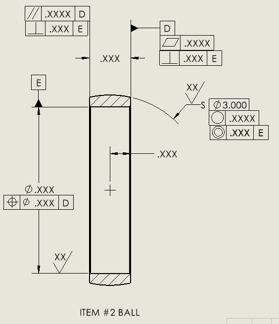

This was done by someone who I cannot reach out and ask. I am trying to make sense of his measurement drawing, it's not easy since I am a noob as well...
It has 3 axes as datums A, C and E, I am pretty sure that's not correct, one axis (datum C) should be enough IMO.
Also, none of the TP callouts have basic dimension.
Moreover, calling TP on the ball dia does not make sense to me.
Calling two flatness on the race seem to be not needed, especially if both surfaces are controlled by perpendicularity already.
Is form control on the ball OD a good idea?

Concentricity was brought up by the vendor, I have been trying to understand the basics and to determine if the way concentricity was used is even correct/legal first before I reach out and ask. I am not sure what was the reason behind it, I am guessing it's their convection or could simply be a mistake. Bearing standards use concentricity on the race OD with respect to datum E ( to ensure spherical contact?) But I agree that on the component level, concentricity seems to be worse than TP and profile.
The way I understand it is that you are saying datum E and the basic dimension from datum D to the center (forms centerline) won't form the center point of the spherical tolerance zone of the concentricity because they won't necessary intersect? If so, then when using TP, it would have the same problem right? So to fix it, we can use the spherical surface as the datum feature as suggested previously by 3DDave? Or we can add datum F as a midplane while keeping the basic dimension from datum D. That way, datum E is ensured to intersect with the plane.
I would highly recommend asking the vendor how they understand the concentricity requirement without even first trying to determine on your own if what they are proposing is legal or not. As was already brought up in this thread, there are cases (way too many of them) when this geometric characteristic is misunderstood and therefore misapplied.
The problem with Concentricity, unlike with Position, is that by definition it requires all median points of the spherical surface to be congruent with a datum center point. Firstly, I don't think that the datum center point in this context was ever envisioned as a point of intersection of the primary datum axis and the secondary datum plane or center plane; it was rather thought to be a center point established from a regular spherical datum feature. Secondly, since the true location of the center of the sphere is in your case offset from that point of intersection, I don't think you would want the spherical surface's median points to be congruent with that point.
For Position all you care about is that the center point of the Actual Mating Envelope of the spherical surface (which for an external surface is the smallest perfect spherical envelope circumscribed about the actual surface) is within the position tolerance zone. But in this case the tolerance zone can be located anywhere relative to the datums used to establish the DRF - either at the datums or totally offset from them.
While from the functional point of view, this would most likely be the right choice, it would fix the problem to some extent only. You would still need to find a way to control the same type/nature of form error that the originally applied concentricity tolerance was able to control, namely the "symmetry" of the distribution of the form error relative to a datum, assuming you trully cared about it. If you didn't, then that would just be another argument for not using Concentricity at all.

I certainly am not in favor of the scheme with concentricity, but I find it interpretable (per the 2009 or 1994 versions of the Y14.5 standard).
"7.6.4.1 Concentricity Tolerancing. A concentricity tolerance is a cylindrical (or spherical) tolerance zone whose axis (or center point) coincides with the axis (or center point) of the datum feature(s)"
I see no indication that the center point of the spherical tolerance zone can only coincide with a datum point or the origin of the datum reference frame. Although not common, the center point of the spherical tolerance zone can also be congruent with a datum axis. This is the case in the scheme in which concentricity is used with reference to datum feature E as primary which provides the datum axis, and to datum feature D which provides an additional constraint, while the basic dimension from it defines the exact location of the tolerance zone along the axis and relative to the datum reference frame.

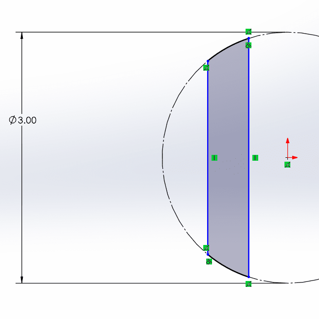

A quick question on the datum. Would the accuracy of datum E be an issue since the L/D ratio is so small? I am thinking the primary datum should be the flat surface (datum D), and define datum E as secondary with perpendicularity based on datum D.
Above is vendor's version, what is the biggest issue with this version besides that size of sphere is not controlled? Technically, even though it's not an ideal drawing, it's actually legal? Since it has a dimension from datum D to the center. It prevents the spherical surface to become the following, right?
Well, the fact that the size of the sphere is not properly controlled may actually be a first indicator that the vendor doesn't really understand what they have put on the drawing. Also, ignoring for a moment the whole conversation about the correctness of application of concentricity, the lack of secondary datum feature reference in that feature control frame does not prevent the spherical surface to become as you shown in your sketch. I assume the horizontal .XXX dimension from the surface D to the center of the sphere is there to prevent this unwanted shape to happen, but since it is not shown as basic, there is not even a standard interpretation for it. An additional element that looks strange, at least to me, is that the hole E is controlled for perpendicularity relative to D (by incorrectly using the positon symbol) and at the same time the surface D is controlled for perpendicularity relative to E. In summary, these are all sufficient signals, again at least to me, to check if the vendor really understands concentricity tolerance.

I made some portions of the two quotes you provided bold and the reason for this is that I believe the intent of the statements has always been to consider concentricity of a spherical feature relative to a datum center point established from another spherical feature.
The datum center point mentioned in both quoted paragraphs doesn't exist on the drawing and on its different variations that are being discussed here, so this is where everything fails. Unless the concept of a point on a line located at the intersection of datum axis E and datum center plane D is introduced.
Of course we could explore some other options, such as for example that the median points of the spherical feature are found at the section planes perpendicular to the datum axis, but then in my mind this would question the need for a spherical tolerance zone and in general would be another stretch.
