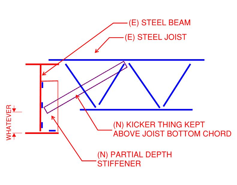

Does tying the joist to the support beam to restrain twist of the beam impact the joist? Doesn't the joist now need to handle the torsional moment that it's restraining from reaching the support beam? I'd appreciate your thoughts; our joist supplier will likely not want to support any additional loads.

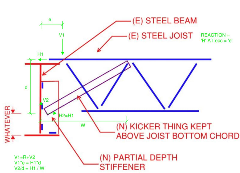

I was curious how the member forces would be effected by KootK's cool idea of bracing to the joist itself to take out it's own eccentricity.
You'd increase the vertical shear demand (and the reaction from the joist seat to the Beam top Chord) on the first two diagonals by 'V2'. You'd increase the compression of the top chord (only within the end panel) by 'H1'.
Solve for the three unknowns V1, V2, and H1 with the three equations gives...
V1 = R / (1-e/W)
V2 = R * e / (W - e)
H1 = R * e * W / (d*W - d*e)
OP said:
does tying the joist to the support beam to restrain twist of the beam impact the joist? Doesn't the joist now need to handle the torsional moment that it's restraining from reaching the support beam?
Yes & yes. It's a very common means of retraining a beam torsionally against various things:
1) lateral torsional buckling.
2) lateral loads applied to the beam bottom flange.
3) minor load eccentricities in the beam.
As cal91 has nicely illustrated, there are both horizontal and vertical loads imposed upon the joist. That said:
4) flexural compression forces at the joist top chord (midspan) should dwarf the horizontal force here by an order of magnitude or two.
5) the vertical force should be small-ish relative to the joist end shear capacity.
That said, it kinda depends on how minor your torsion is. What's the joist span? What's the eccentricity? What is the beam span?
This scheme also requires that some joist axial be transferred at the joist seat to beam flange connection. Cal91's H1. Usually not a big deal.

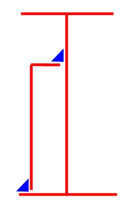

A lot of folks clearly like the side plate idea. Depending on your weld access situation, you could achieve virtually the same thing with an angle or bent plate and only top-hand welding as shown below.
charlie said:
That way continuous welds would not be needed.
Continuous welds would not be required regardless. It's an old structural engineer's wive's tale that one can't stitch up a closed, torsion section.

We're trying to get our joist supplier to agree to adding a kicker to restrain the bottom flange as we believe this is less work than having to reinforce the supporting beam for torsion as well as adding restraint to the shear end connections.
