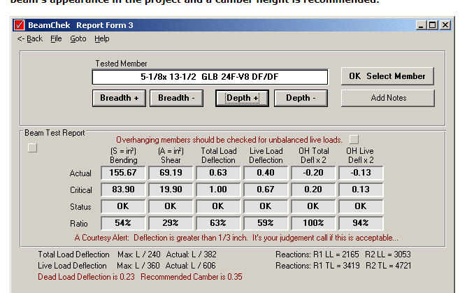

I checked out the software you said was used and saw this image which makes me feel that this could be easy for someone to mess up.

That beanchek program is something nearly every architect around here uses. Mostly for flitch beams, but it's cheap and as you can tell not a great program.

Does anyone know how much natural camber would even be on a beam like this? And is cambering a small amount difficult? I truly have no idea. Don't think I've called for camber in a steel beam ever. Seems reckless that a program like BeachChek can even recommend camber like that. DL posted the screenshot above and it shows for wood beams too.
I think natural mill camber tolerance is limited to 1/8" per 10' of length. I believe the tolerance for induced camber is -0",+1/2" plus 1/8" per 10' over 50'.
