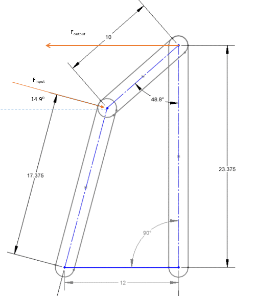

The question in a nutshell: A torque is applied to Link A, what is the resultant torque to Link B?
Here is a simplified diagram:
Here is the geometry:
Basically, I have a system wherein a link arm (Link A) is attached to a gearbox, that link arm is attached to a short link (Link C) that is then attached to a third link (Link B), or the object that I am seeking to rotate. For a given input torque (to Link A) I would like to calculate the resultant torque to Link B in various positions, the position being shown is the starting position, Link B will be rotated CCW in 10° increments until it rests in the 9:00 position.
I have contextualized the torque as perpendicular vectors that converge in space, the geometry of which is used to create an output percentage. The torque geo being:
The output percentage being: 1.26 or 126%
My question to the group is: does this track? Is there a better way to calculate this?
Never depart from your basics. Make a free body diagram for each of the 3 links. Once you algebraically determine the X-Y forces acting at point B-C, then the portion normal to the link B axis can be used to calculate your torque. Your algebra will need to be done in terms of the linkage angles, which can change.

I think, rather than a FBD, you need to do a kinematic model. The bottom two points are fixed, the upper two points move.
You may need to static equilibrium of different positions, but then these are static equilibrium views of a non-static structure (so there is some energy in the rotating members, possibly small.
It's years (decades !) since I did a mechanism but I picture that you need to consider the stiffness of the output (and input ?). If you apply your input load, I picture that there can be an equilibrium set of reacts. Possibly not, if the links are two force members ... maybe look into force polygons, with the links at different angles. Though I'm not sure that'll give you a definitive answer ... it may only give you a direction ? But then scale based on the input load ??

I like the energy method for such analysis. F-input generates a torque through an angle which is work. F-output should generate work of equal magnitude.
T-input * delta-theta-input = T-output * delta-theta-output.
T-output = T-input * delta-theta-input/delta-theta-output
If one has a CAD model, then the ratio of theta-input/theta-output can be generated by making a small change to theta-input and measuring the change in theta-output.

This one is pretty easy since the one link is vertical. F output is simply the x component of the F input. You can then calculate the resulting torques. But it seems that torque is irrelevant to your problem.
is there not an x component in the LH reaction ?

To clarify, I am looking for the efficiency loss through this system. Basically, if the torque generated about the fixed point of Link A is 100, what is the torque generated about the fix point of Link B? It's possible that I have over complicated this and it's simply a ratio between the lever lengths, therefore:
Link A / Link B * 100 = F out
Or
134.53
That is not a statement, but a question.
"delta_theta" means a change change in theta ... rotate the links to a slightly different angle (like change the 90deg at the RH support to 80 degrees ... how does the other two link move ?)
summing torque about the point of intersection (good idea) you get RL*25.5707(?) = RR*32.2326.
for static equilibrium. you also have ...
sumFy ... Fin*sin(alpha) = RR-RL*cos (theta) ... theta and alpha are obvious angles (?)
sumFx ... Fout-Fin*cos(alpha) = RL*sin(theta)
but I suspect that this structure is not solveable, not in static equilibrium, that it needs a diagonal link to be stable. Fin and Fout must be in a specific ratio else it falls over.

Assuming this is a static case, there will be equilibrium of torques.
So, Torque=17.375Finput=23.375Foutput
So the force ratio is Foutput=17.375/23.375Finput=0.7433Finput.
But if it is a dynamic case, the inertia forces and moments need to be considered also.
Engineers, think what we have done to the environment !
"Torque=17.375*Finput=23.375*Foutput" ... I don't think you can say this, as you're taking torque about different points (Fout about the RH support, Fin about the LH support).
I think you should sum torque about a point, like the RH support, so Fout*23.375 = Fin*(<17.375)+RL*(<12).

Yes, there is a confusion about the point of rotation.
Instead we consider moments about the bottom horizontal line.
For static equilibrium,
Finputcos(17.90)*17.375 cos(17.90)=Foutput*23.375
Or
Foutput/Finput=0.6942

no, we consider moments about a point. Torque here is Mz. Torque about the RH support includes the LH reaction.
But I don't think we can solve the structure with equations of equilibrium, because it is a mechanism (because it lacks the diagonal member). If we try to build a force polygon with the 5 directions (the three links + the two forces) there is no single solution.

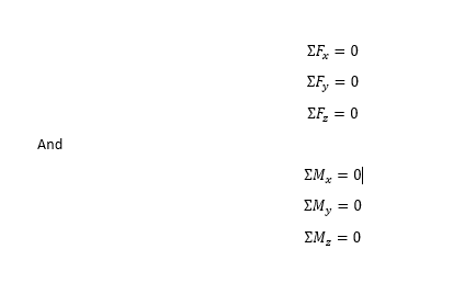

In the textbook, we apply the general equations of equilibrium as follows;
Here x, y and z are coordinate axes
We can go into individual links, but in the overall, the combined structural equilibrium needs to be obtained, otherwise it is a dynamic case, not static.

It's a 4-bar linkage.
The "ground" is the fourth bar.
Using the correct name in Google searches like "four bar linkage simulator" or "four bar linkage equations" will get you plenty of useful resources.

I had a go at solving the posters problem by finding the parallel force in the two bar link and then just using that force to obtain the torque about the longest link.
My estimate for percentage torque output was around 1.28 so very similar to the OP's answer.
being snarky (!!??) I'm surprised the answer is not negative. The OP has shown both Fin and Fout positive in the same direction.
I can see that the problem can be expressed as three unknowns (RL, RR, and Fout/Fin) and three equations of equilibrium so statically solvable,
and by solving this we can determine the loads in the links.

I did it graphically, I assumed a torque on link(A) and knowing that the force in link(C) has to be parallel to the link I calculated the force on link(C) at the intersection of the links (A)& (C). Now the force at both ends of link (C) must be opposite and equal and so from that force and its direction it’s fairly straightforward to calculate the torque on link (B).
