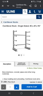

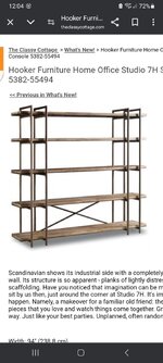

I think you can get a very simple and clean block machined with a T shaped pin or pins on the reverse which then slot into keyhole shaped slots in the frame. Very strong and would look "magic" as there is no visible means of fixing.
sort of like this?
