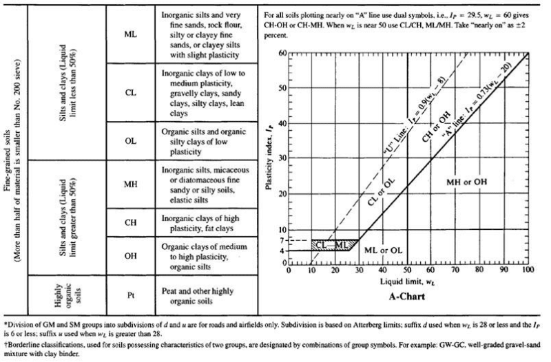

I'm curious what everyone's thoughts are on the usefulness of the USCS and it's derivatives to classify soils for engineering purposes (or more broadly the joys of soil classification)
The advantages I see: Has been used extensively, large availability of correlations
Some points I've been contemplating:
[ul]
[li]Is the A line on the Atterberg chart actually useful? I've found the usefulness of it to largely be: more plasticity = more clay content (or a higher fraction of more active clay minerals) The silt/clay choice being based on being above or below the line has never made any sense to me. The golder version of the USCS calls plastic soils below the A-line 'Clayey silt' rather than 'silt'. I've also worked for employers that just ignore the A-line and call all plastic soils 'clay' with modifiers for varying silt and sand content.[/li]
[li]Is the 50-50 split between 'fine grained' and 'coarse grained' actually useful? I've never found calling a soil that's 55% sand, 20% silt, 25% clay 'clayey sand' to be a useful classification - and contractors and developers often see the word 'sand' and interpret it to mean 'beach sand' and then accuse the geotech of being a moron when it looks like plasticine. [/li]
[li]Does a USCS classification actually tell us anything about engineering properties? Eg. Strength, stiffness, permeability [/li]
[/ul]
I' find completely ignoring the soil classifications and solely looking at shear vanes, SPTs, lab results and CPT results to be substantially more useful.

I poorly responded to yours, EireChch. Show me on the plasticity chart where the sandy silt plots and I'll give you a better response.
What 'elastic silt' particles
I know if you add organics, that will cause soil to plot below the a-line. Likewise, there are certain clay minerals that cause plastic fine grained soils to plot below the A-line. Calling it silt seems bizarre, since silt has nothing to do with it.
ML and MH?
It plots below the A-line because of the type of clay particle that's in it, it doesn't have anything to do with silt lol that's the point I'm making.
Soils below the A-line: Have certain types of clay minerals, and are called 'silt' because they plot below the A-line
Soils above the A-line: have certain types of clay minerals that plot above the A-line, are called 'clay'
In many practical cases the soil above and below the A-line is majority 'silt' on a size classification basis but it's behaviour is dominated by the percentage and mineralogy of the clay fraction
