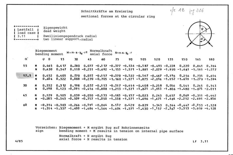

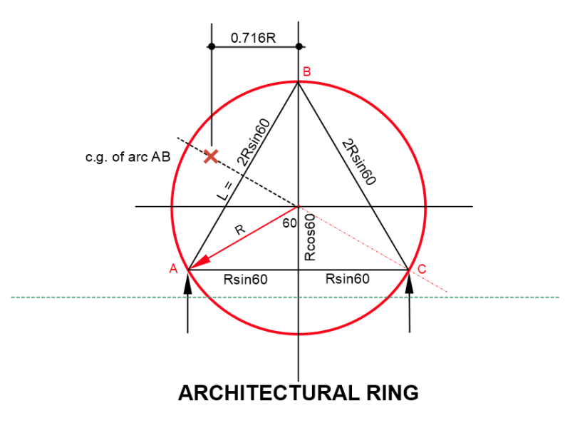

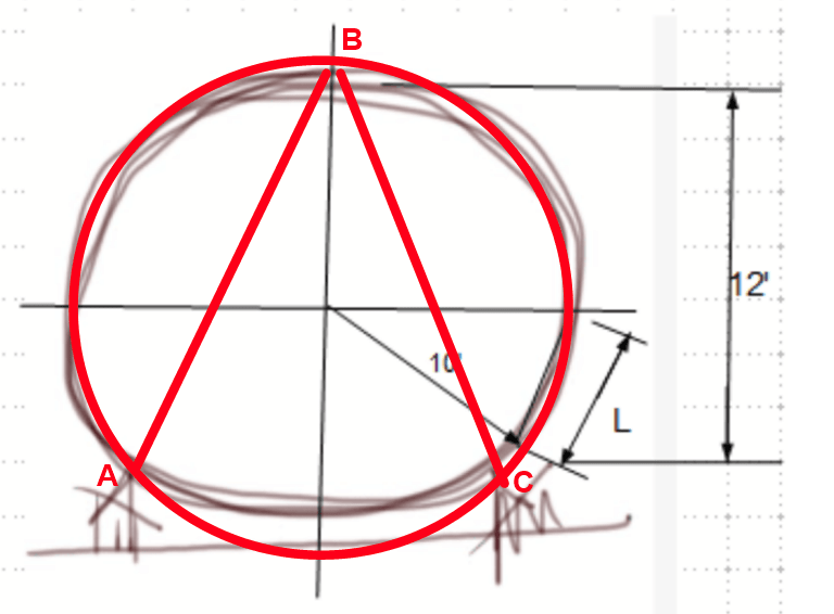

I don't think the circular arch is less critical than the three hinged arch, ABC shown below. So a good starting point for buckling length would be length AB or BC.
BA
Robyeng,

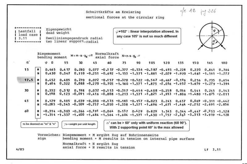

Do you have table for φ = 102°, and ∝' = 78°? In the formulas, what are m, n, s and ϒb represent?
BA,
FYI. Your starting point is, for L = 15.5', t ≅ 7.25" to avoid buckling prior to yield.

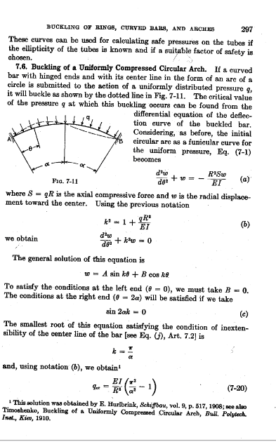

The following is a page from "Theory of Elastic Stability" by Timoshenko and Gere for a two hinged circular arch. It illustrates the buckled shape of a uniformly loaded circular arch. I'm not sure whether it applies when the included angle of the arch exceeds 180o, which this one does. If anything, I tend to believe it would be even more critical, but have not gone through the mathematics to check on that.
BA
BA,
I leave it to you to compare the result from Timoshenko and Gere to mine. I wonder how much the results differ too.

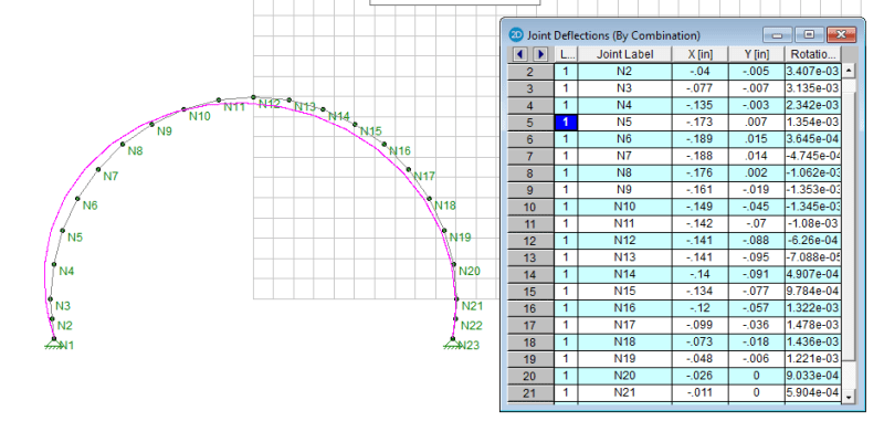

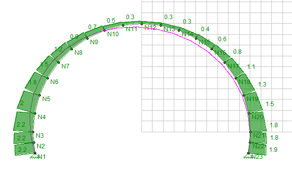

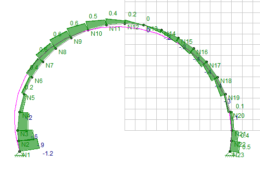

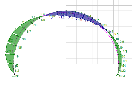

The diagrams below are the results of 3" thick horseshoe shaped metal dome subjected to 50 psf wind load. The design is governed by deflection rather than stress (1" will satisfy stress limits, but too flexible). [ADD: width = 12"]
Axial Force -
Bending Moment -
Shear -
Deflection -

So would I look at bending stress, but you can't ignore the fact that there will be some compression in the arch. It won't be much axial force because there isn't much load, but there is some and what I was suggesting in the diagram was that the buckling length for the curved arch is approximately the same as distance AB or BC on the diagram.
The proposed member is a plate 20" x 3/4" which has a cross sectional area of 15in2, a unit weight of 51#/' and a radius of gyration of 0.2165in. If the diameter is 14'-0" and the space between supports is 12'-0", then AB = 12', so L/r = 144/.2165 = 665, somewhat more than the code would permit for a compression member.
EI = 29e6*20*0.753/12 = 20,390,000
Pcritical (Euler) = pi2EI/L2 = 9,705#
Total weight of ring = 51*π*14 = 2243#
Total weight of snow = 50*14 = 700# (probably a bit generous, considering the slope)
Reaction at A or C = 2243/3 + 700/2 = 1097#
So it won't fail by buckling, but with an L/r of three times permissible, it had to be checked.
Having done that, I would move on to analyze the arch and I expect it works but leave that to the OP.

If the radius is 10' and the supports are 15' apart, then length [highlight #EF2929]AB = 15', L/r = 831 and Pcritical = 6200#[/highlight] AB = 18.2', L/r = 1008 and Pcritical = 4211#. Reaction at B and C = 1435#. Probably starting to get a bit limber. How far are we prepared to go?
Edit#2: If points A, B and C form an equilateral triangle, then length of AB, L = 15' and the red highlighted figures would apply. But the radius would be 8.66', not 10'.
