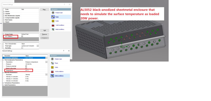

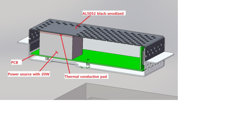

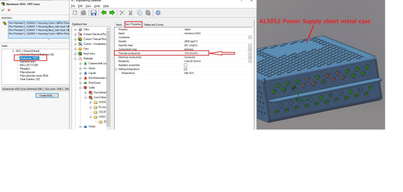

Thank you, WKTaylor. Refer to the JPEG files attached. To run a flow simulation with the SolidWorks Electronics Cooling for the simulation case as described in the attached, I need to know the value of the thermal conductivity that I can punch into the item properties of AL5052 anodized. The SolidWorks simulation software provides the AL5052 thermal conductivity as 138W/m*K from its engineering database, but it is for non-anodized surfaces. The unfinished surface of aluminum can be measured at an emissivity of approximately 0.05, while the emissivity of an anodized aluminum surface can be measured at around 0.85. In this condition, what would be the correct # for the thermal conductivity of AL5052 black-anodized power supply enclosure? As shown in the JPEG picture, the power supply sheet metal box is to be subjected to a thermal chamber at 25 degrees C.
If this is going in to another enclosure then most of the emitted heat will be reflected back.
Conductivity will also not matter much as it doesn't appear that it has any place to conduct the heat to.
This will be a convection cooled item - either forced convection if there is a fan, or free convection if there isn't one.
SolidWorks Electronics Cooling appears to perform thermal distribution for circuit boards and the components on them. You need the SolidWorks Flow Simulation module to get the heat transfer out of the enclosure.
Hi 3DDave, thank you for the valuable input. As illustrated in the screenshot, the heat resource is to be conducted to the AL5052 anodized enclosure through Thermal Pad, and I need to simulate the outside touch temperature of the enclosure. It is one of the simulation scenarios in which the power supply will be subjected to the inside of a thermal chamber, that is the case you started as "the most of the emitted heat will be reflected back", however, there is another sim-case with no the thermal chamber that will represent a real-world installation in the airline cabin. With the delta emissivity between unfinished and black-anodized AL5052, I need to know how to deal with the thermal conductivity of AL5052 at 25 degrees C in the SolidWorks Flow Simulation. The engineering database in SolidWorks Flow Simulation provides the thermal conductivity of AL5052, but there are no data for AL5052 "anodized". It would be great if you have any info related to my question in handy that you can share in this forum. Thank you!
Instead of dealing with the thermal conductivity value for AL5052 anodized, it might be more appropriate to adjust by defining thermal/contact resistance between the components. In this case, do you have some data in handy on the thermal/contact resistance value of the aluminum anodized material that you can share? Thank you in advance.

Hi WKTaylor, Noted well NOTE1. Thanks. Regarding NOTE2, the purpose of anodization to this particular product is for thermal characteristics solely that reduce its surface touch temperature as run the thermal inputs in an ambient and thermal chamber. No functional or decorative but thermal characteristics only. According to your comment on NOTE2, anodized or non-anodized might be negligible with .050" thick sheet metal case. I need to prove the theory by running a simulation study with the correct material properties, but it seems very hard to find that value impacts a reliable simulation result. I will keep looking at internal docs as well as the docs you listed in NOTE3. Thank you so much for your kind support.
Hi 3DDave, thank you so much for the input. As suggested, I will add the simulation input conditions with Contact Resistances between the components and will monitor the simulation results accordingly compared with the actual thermal testing results in the lab. Thank you again for sharing the links.
