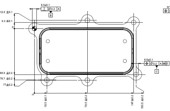

I was asked about possibility of making a functional gage.
There is s slice from the technical drawing:
I understand, that because of RFS Material Condition Modifier placed in feature control frame of datum B, i need to use equipment (some expanding kind of pin, spring pin or tapered pin) which are capable of locating axis of the hole.
Now: Datum C hole feature control frame may be read as follows: The axis of the hole must be positioned within a cylindrical tolerance zone of 0.2 [mm] diameter at RFS. The tolerance zone is perpendicular to datum A, located down from datum B at it's MMC and over from datum B at it's MMC.
What I don't understand is how to sum up this two tolerances: one from feature control frame and another from line dimension tolerance.
The other four holes are described as:
Is it even possible to make functional gage for this, or am I wasting my time?
There are no basic dimensions on drawing, is it correct for gd&t dimensioning ?

It can be done. But it will br more expensive.
Also carefully consider the rrasons you arr not allowing MMC. Does it really matter that much?
What standard are you using?
In short - no. Position tolerance combined with +/- direct tolerancing of location is not a valid combination in ASME and cannot be evaluated. I am quite confident it is a similar story in ISO.
From the ASME Y14.5-2018 appendix:
Y14.5-2018 Mandatory Appendix I para I-2 said:
Tolerances directly applied to location dimensions for regular features of size were removed from this dimensioning and tolerancing Standard in 1982, and they are not included in the alternative practices in this Appendix. There is no defined meaning in this Standard for a tolerance that is directly applied to a location dimension that applies to a regular feature of size.
With this in mind, while an RFS functional/hard gauge is certainly complex and expensive as TheTick noted (MMC would be much easier and more representative of function in most cases) - the combination of +/- location and position tolerances makes it impossible to evaluate according to the standard. Its wholly up to individual interpretation as to what it should look like.

The problem is, that I am not author of this drawing. I can't decide if it is at MMC or not.

Drawing was made in ISO 8015
It's a completely invalid position specification. You must have basic dimensions locating C. Plus, you need at least one more "clocking" datum, I don't think it's A but we can't see A. But since B is perpendicular to A I think A is in the plane of the view. You can't inspect this drawing with any gauging, send it back.

You are right - datum A is in the plane of the view, it's base of this part.
So now I should send back this drawing with adnotation what they need to do:
1. Consider allowing MMC
2. Line dimensions change from toleranced to basic
am I right?
Thank you all for your helpful answers.
Customers are not always right. Time for sone dialog.
Give them a quote for the gage with GD&T as-is. Also prepare a second quote along with changes to the GD&T.
Money talks. Sometimes it teaches.
ISO or ASME, as it was previously said, a functional gage (with fixed size gage elements) cannot be used if (M) modifier does not follow the tolerance value in the tolerance frame and if the dimensions used to define nominal location of features are not basic (in ISO they are called theoretically exact).
