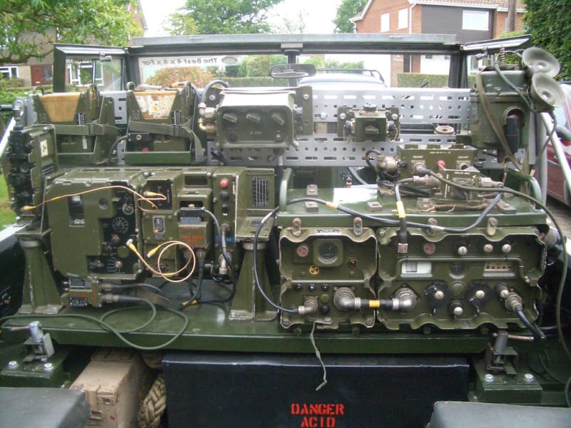

We used to have army vehicles that were capable of doing this to charge radio power packs. And they were being used 40 years ago.
There was a hand throttle in the front that you could set. They pumped out 24V. It would be relatively easy to exchange the battery charger for an inverter on the end of the output.
We used to call them Clansmen rovers. They had a beefed up generator on them.
Found a pic of the back of them. The black box at the bottom had the "hotel" batteries in them for internal use and there was a plug at the back that you could plug the command post setup into. But from memory it used hellish amounts of fuel.
