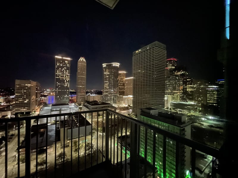

As you point out one of the missing factors is the lack of ability to control demand. Most of the commentary has been about the failing supply (due to the cold) and the increase demand (due to the cold). But there doesn't seem to be any ability to actively manage demand. Empty office buildings lit up and presumable heated too isn't a good look!

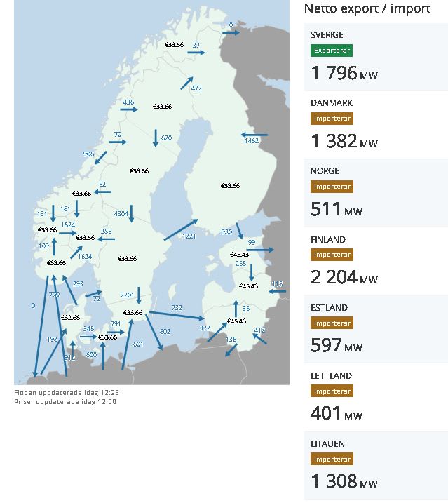

Here is how it looks for Scandinavia and the Baltics right now.
Best regards Anna
Albert Einstein
Lithuania is having that fight with Belarus over that new reactor so that's doing funny things.
Plus all three Baltic states are still synced to Russia
