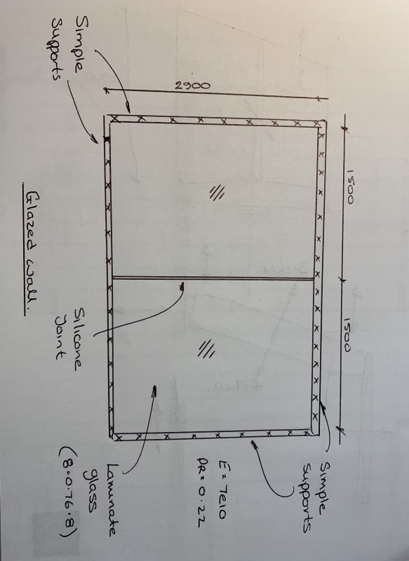

I am trying to model 2 panes of glass butt up next to each other. Both fixed on 3 sides and fixed to each other at the edge joint using silicon
As these deflect there will be tension load between the panes where they are butted together
Could anyone suggest how to model this?

Can you provide a simple schematic/sketch of this structure ? Depending on the dimensions you may want to model the joint's geometry. Otherwise you will have to approximate this connection, most likely with tie constraint.
Tie constraint may be sufficient in this case, unless you want to account for joint’s strength (then you will have to model it explicitly). So it mainly depends on the exact purpose and assumptions of the study.

The only thing I need to know is the max amount of tension in the siliconed joint kN/m

I have now modelled this as a 1 sided model i.e. supported on 3 sides. I can see it deflecting on the unsupported side which means there is tension on the rear side of the plate but how can I get ascertain the amount of tension at a mid span node?

Have you applied the symmetry boundary condition to the free edge ? You can use the NFORC variable to read nodal forces in the model.

It should be applied to the boundary where your model was cut in half. In the normal direction so if you utilize symmetry in the X axis, for example, then you need XSYMM boundary condition.
