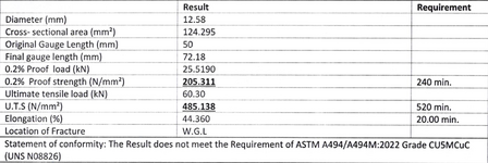

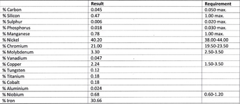

Tensile failure observed in Cast ASTM A494 Gr. CU5MCuC
A M Contractor
Industrial
Aug 8, 2017
13
IN
Dear #EdStainless
Heated to 1175° C, soaked for 2 Hrs, Water Quenched. Stabilizing to 970° C, soaked for 4 Hrs, Forced air cooled.
Results are not achieved. Please provide your valuable input. 1731234978050.png
As per SA-494 Clause 6 Note-1, heat treatment at higher temperature may be required.
I am not a metallurgist. Please talk to your metallurgist whether the temperature can be increased.
My personal suggestion is;
Homogenize at 2200-2250F for 4-5 hours, cool to RT, then anneal at 2150-2175 and water quench.
Check the micro, and then stabilize, and check micro again.
I am in process. I will update as soon as I get results. Thanks
Dear EdStainless
This is the micro structure after heating to 2210 F, cool to RT, annealed at 2150 F and water quench. Stabilizing at what temp will help me get results in this material?
