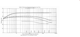

OK, test pieces in with parts will see longer times at temp, but the temps are the same.
Or you can strap the samples to an actual piece so that they heat more slowly.
Times are not super critical.View attachment 10777

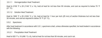

Thank you for your comments. Attached is a screenshot of the heat treatments for 17-4PH cast. I need specimens in solution condition (because I require my castings in this condition for machining) and H925 condition to know how they respond to the ageing heat treatment. The thickness of my castings is about 2.2 inches with a weight of 35 kg. The manufacturer casts my specimens already with final dimensions (6.35 mm gauge diameter and 10x10x55 mm), he does not use coupons to machine the specimens from them. I proposed to use coupons to heat treat them in the same load as my castings and save $5700, but he says it is better to heat treat the specimens in another load. Regards.

1. HT the coupons in the same production furnace is nuts. This what calibrated lab furnaces are for.
2. The stress argument is nuts. You anneal and machine, then age. The aging treatment is an an effective stress relief.
Of course using H900 or 925, or even 950 is very risky. The tensile strength will vary a lot from batch to batch. Minor differences in chemistry, annealing temp, and aging temp will all effect properties. That on the toughness is very low.

H925 according to the spec is equivalent 38-45 Hrc , this is the approach I would take, make the test specimen same as the wall thickness, after heat treat machine to correct size for testing. that hardness is easily machined with out compromising. run the parts with test specimens.

Thank you for your comments. Just to clarify, the heat treatment will not be performed in a production furnace.It will be done by an external company that operates vacuum furnaces, Tih process is being carried out specifically for a first article inspection.
