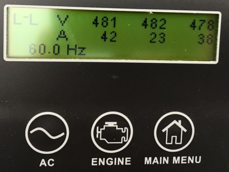

The generator panel has never shown more than 50A @ 480V.

They have three dry type 25kVA 240/480 transformers they just found so I might switch to those for the 50A/480 load (BTW it was found to be 40A today and not 50A.

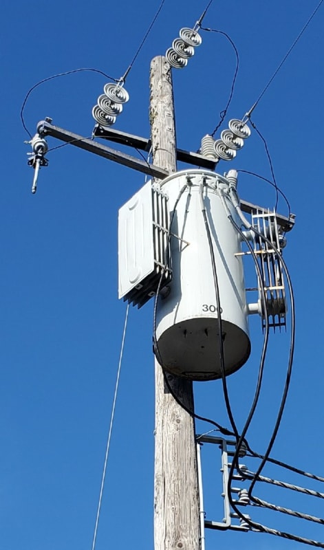

Well %$@^, as I was talking to my contact he mentioned some of the lights in one building are...277V meaning there's a neutral lurking. Asked how this is possible and was told both 400kVA generators have large jumpers between "ground and neutral". So after all the planning, wire sizing, and re-configuring the rail yard that was done I decided to go lay eyes-on before anyone pulled out their wallets for hundreds of feet of 4AWG SO cord.
And low and behold..
A WYE secondary.
I dug around and found a 230Δ-480γ/277 100kVA which they can get, use, and re-sell in a couple of months since they're rare as hen's teeth. We'd now feed 240Δ down the HEP and after the train transform to Y.
We'll see what management wants to do Monday. The saga continues.

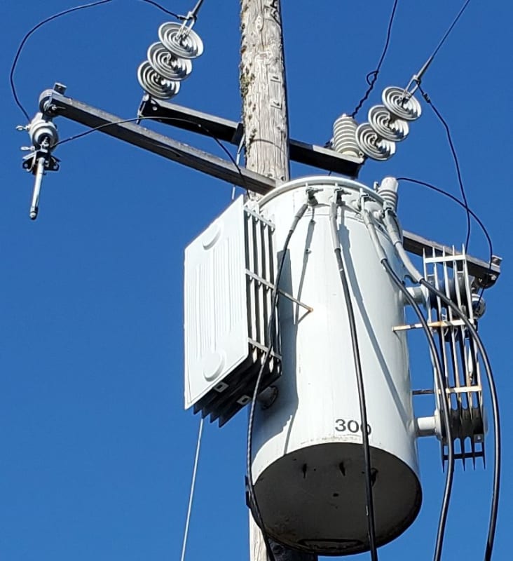

The transformer in the picture is probably a 120/240 Volt secondary. For use on a 120/240 Volt circuit the windings may be paralleled without going inside the case and into the oil to change to a 120 only configuration.
I have seen three bushing transformers fail shortly after being reconnected for 120/208 Volts.
Dirty tools contaminated the oil.
Two transformers failed within a day.
High voltage to 277 Volt distribution transformers are common and have two secondary bushings.
As for 277 Volt lighting.-
That is common for 277/480 volt wye systems, but ballasts tapped for 120V, 277V and 347V are common here.
The lighting may be 120 Volts with a 277 Volt tap. Verify yourself if possible.
I see only two primaries on that pig.
A three phase, 277/480 Volt pig will have three primary connections.
I may be wrong, but......

That may be 240/480V four wire delta.

Hi Bill,
That pig is a 21kV to 480/277. There are 3 primaries.
Here's maybe a better crop at it.
