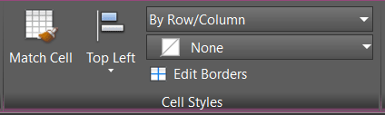

If you hold down Alt and hit Enter it should put a carriage return and allow you to use multiple lines in a single cell.
Pinwards: great, it works... thanks... any idea of how to get rid of the borders?
Dik
If you grab a cell in the table it should bring up the Contextual Menu at the top with a button "Edit Borders" in the Cell Styles portion.
Or you can grab a cell, then right click and Edit Borders.

Works Great... thanks
