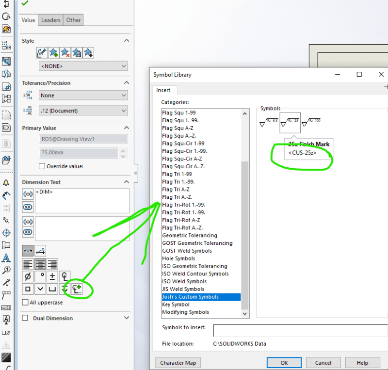

Last week when I was exploring about dimension styles. I recorded a macro adding box as prefix to a dimension as a part of this learning.
The statement recorded was:
Code:
boolstatus = ModelDocExtension1.EditDimensionProperties(0, 0, 0, "", "", True, 9, 2, True, 0, 0, "<MOD-BOX>", "", True, "", "", "", False, 2, "")
I was wondering as to where from this string "<MOD-BOX>" originated.
I found that it comes from the gtol.sym file - the symbols definition file.
Then I asked myself, how can I remember this string? And there are at least a few hundred symbols if I am not wrong.
So, I thought it would be a nice idea to have a list of all strings as ready-reckoner. It will save time for programmers.
So, I started it and added details of three items in the uploaded SwkSymbolsInApi.xlsx file.

That's the first thing I always do. Could not find anything remotely related.
This is built in to SolidWorks. Just click the "More symbols" button and you can see the entire library. To get the string for any symbol, just hover over it.
Thanks very much Handleman for informing.
Is it mentioned anywhere in help?
