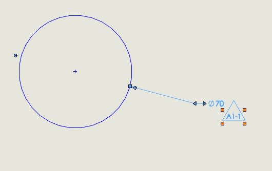

How can we create custom symbols in Solidworks 2021.
we need "FLAG TRIANGLE" with numbers inside (A1-1, A1-2, B1-1, C1-4)
Existing Flag tri symbol does not allow me to change these letters.
Use case:
We are trying to mark the revised dimensions with notations.

Hi
Balloons can not be inserted in to dimension text.
We need to insert the symbol into dimension text. So that the symbol and dimension will be inline.
Thank you
You didn't mention to add it to text.
If you select the letter or number in the text, in feature tree select "Border", change to triangle.

Hi
Kindly refer the attachment
Thank you
Those look like a special font.
You can group a note to a dimension which will keep it located approximately where you place it relative to the dimension.
Considering you have to manually add this balloon/flag to the dimension text in your desired "use case" I don't know if it's much different than manually placing the triangle flags?
