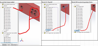

My flat tree view was unchecked. and here's the expanded and coliapsed views of tree:
Example, in 1/4-20 hole use the Sketch11 to add more points, or construction lines, within the sketch. You are adding another not needed sketch15 to locate your holes. This is why sketch15 is outside the hole feature.

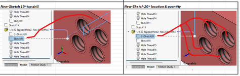

Sketch 11 is the sketch of the tap drill hole. Sketch 15 tells the feature the location, and quantity of holes on the surface. Historically both sketches stay within the feature. And when I put a fresh hole in it shows up normally.
Below are screen shots of the original, after saving and opening. And below that are new ones added that show up the "normal way". And after saving and opening the new feature kicked out the sketch 20.

So if you open it, and it shows the sketch outside of the feature, try deleting the sketch, then undoing. I do that and it brings the sketch back into the hole feature., but after saving and opening it kicks it out.
This is a reported issue/bug (BR10000387004), and fixed in SW2024 SP4 with Hotfix. You may contact your VAR, and they would help with the required hotfix.
