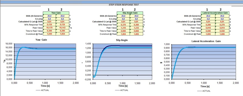

i was doing short test in my Dynatune-XL :-) , here is Step steer result
if my car have improved front axle
car 1 use extra rear toe (dark blue curve)
car 2 have stiffer rear axle (light blue curve)
i think difference is evident
(car with softer rear axle but with more rear tire cornering stiffness can get same result like car 2 )
i hope i understood
Your DynaTune is actually a Dyna-Tuna because something is fishy.
First of all, your 'Yaw Gain' is actually 'Yaw Velocity Response Due to 20 Deg SWA Input at (I'm figuring) 120 kph'. Same for Lateral Acceleration. The 'Gain' terminology would/should be put on the ratio of Output to Input. For this metric, the Gain is about 4.6 g/100 deg (to use an industry standard). This is a rather high number, BTW.
Second, Lateral acceleration for the constant speed conditions you have created consists of a yaw velocity component and a body side-slip component (probably the one labeled 'Slip Angle' and rightly so). Notice that the 'Slip Angle' figure contains a response trait at Time == 0+ due to the thrust of the steered axle. This is the normal signature of the side-slip characteristic. So... Where is this signature in the Lateral Acceleration graph ?? It's missing. That tells me that the software is not presenting true transient response, but is simply the yaw velocity channel multiplied by the set speed . Your 0.91 g (steady State) translates to about 120 kph in this case. The steady state is correct, but everything up to the steady state value is false (as in your response time and overshoot numbers are SNAFU). The 'glitch' (as we call it) in the initial Ay transient is a player in road feel.
Third, I don't know which coordinate system Dyna-Tuna is using, but it indicates a +Steer Angle produced a +Yaw Velocity' (not 'Yaw' as in Yaw Angle) a +Lateral Acceleration (both correct) but a +Side-slip Angle (say it ain't so). My Side-slip Angle transducer would produce a negative steady state value, not a positive one. Besides, my sideslip angle would be positive at low speed, negative at high speed (certainly at 120 kph) with it being ZERO at the so called "Tangent Speed". The goal of producing a high Tangent Speed is usually on everybody's To-Do List. A constant radius ISO4138 Test Procedure can hand this to you.
The middle Figure says that the light blue line Sideslip Angle is lower for the same steer and same speed and that the lateral acceleration achieved is also about the same, so the Gain is the same so the understeer is about the same, meaning the Front and Rear Cornering Compliance DIFFERENCE is still about the same. It looks to me like are merely seeing the effects of stiffer tires ALL AROUND.
Post some car details: Weights, wheelbase, steer ratio, estimated tire properties (at least some cornering stiffness info) maybe some tire aligning moment values and I can demo what you should be expecting. Stick to the steady state analysis with this program. Response times are clearly of high value to a driver, but not ones from this program.
I do not know,
maybe my input data are bad?
maybe is software limitation?
also it's very likely that I'm doing this test wrong?!!
then my result can be incorrect?
difference is small because changes are small also ? (rear toe change from 0,3 Dg to 0,4 Dg total)(also rear stiffness change is small)

Well, now we can all have a little bit of fun. With the info you provided, let's throw a Hoosier 225/45-R17 tire on your ride (250 kPa on a wide wheel. At your loads, these tires spit out cornering stiffnesses of about 1390 N/deg front and 1256 rear. Aligning moment stiffnesses are a meek 34 Nm/deg front and 23 Nm/deg rear.
Rubbing your emerald slippers together should give you a front cornering compliance of 2.11 deg/g and 1.78 deg/g at the rear. This recipe was lightly sweetened with a bit of steering compliance. Turning the crank gets you an Ay response time of 0.29 sec at 120 kph and with a constant radius test sim I get a tangent speed of about 77 kph. Your 12:1 gear gets you a steering gain of 3.74 g/100 deg-swa at 120 kph. A bit quick if I do say it. In a nutshell, here is what Dyna_Tuna should get you: (more to follow).
